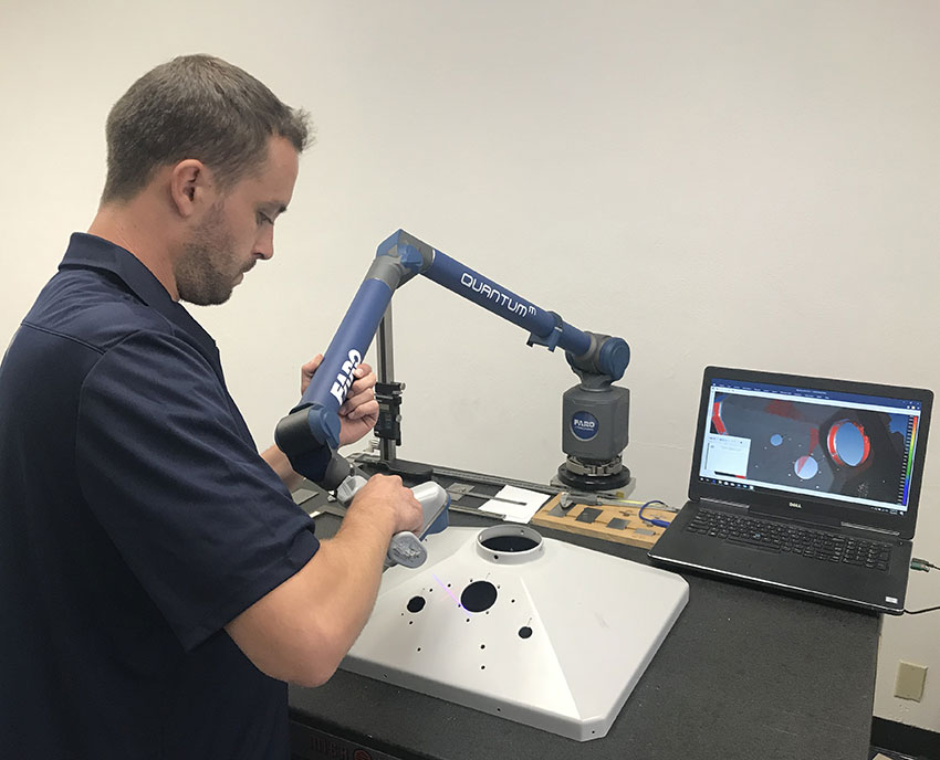

“When I came aboard with ICP, they already had a FAROArm-Bronze using an early version of CAM2 Measure software,” explains Kyle Van Tatenhove, engineer and CNC manager at ICP. “Before coming to ICP, I was primarily using more traditional tools like rulers and gauges.”
The nature of thermoformed products necessitates a more versatile inspection solution than traditional tools.
“There’s a lot of unknown features and geometry that you really can’t measure without a 3D scanner,” says Van Tatenhove. “I’ve also worked [around] fixed CMMs, and I’ll tell you, having an inspection tool like the FARO ScanArm right there in the quality room is pretty amazing.”

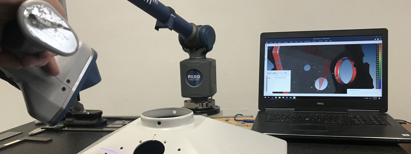

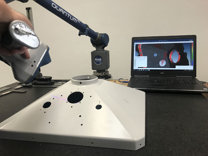

When it came time for ICP to upgrade its inspection equipment, it had every reason to once again choose FARO products. Accuracy, reliability, and affordability were features that led the team to invest in the FARO QuantumM ScanArm with the FAROBlu High-Definition Laser Line Probe.
The FAROBlu high-definition camera uses the most advanced complementary metal-oxide semiconductor technology to deliver fast frame rate (the number of times per second that the camera gathers new data on the part being scanned) of up to 300 frames per second. This equates to approximately three times faster scanning than currently available red laser technology. Because the blue laser has a shorter wavelength than red, a blue laser can deliver improved scanning results due to its intrinsic higher resolution, with a 50-percent reduction in speckle noise.
The scanner is paired with FARO’s exclusive CAM2 2019 3D measurement software. With intuitive workflows and insightful reporting capabilities, CAM2 delivers perfect alignment with FARO hardware to gather measurement data anywhere in the production environment. It provides a seamless and relatively easy measurement experience for all users, without the need for extensive training or expertise, along with accurate and comprehensive insight into measurement results.

The ICP crew realized immediate time savings with the updated scanner technology and CAM2 software.
“I would say going from traditional inspection tools to 3D scanning on complex parts easily cuts your time in half,” says Van Tatenhove. “And the FAROBlu with CAM2 software cuts that time even more because the features are all right in front of you. The X, Y, and Z dimensions are very obvious. You’re not looking at an old display with lines and circles, trying to see where your axis is.”
