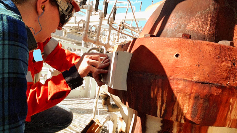

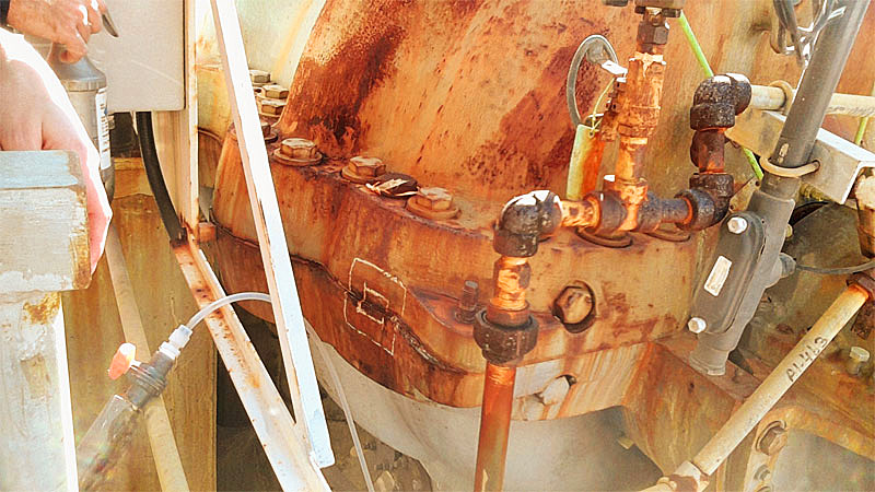

This issue was brought into vivid reality when the Dimensional Engineering team was challenged with a leak repair project for a major refinery. Two companies and five attempts failed to create a patch for a leaking split flange on a compressor.

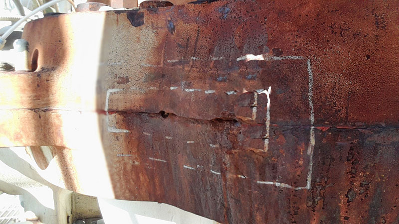

“The system was leaking at one of the bolts clamping a flange,” explains William Bonner, managing director and founder of Dimensional Engineering. “The spot where a patch would adhere was not a machined surface at all. It was very irregular; they could not take hand measurements. Our client already had two different companies try to accomplish it that way, without success. When they contacted us, they had spent hundreds of thousands of dollars just gathering and collating measurement data but were still unable to seal the leak.”
Rather than shut down the entire unit—losing additional hundreds of thousands of dollars—to machine a surface conducive to clamping, the refinery company chose to collaborate with Dimensional Engineering to discover an acceptable alternative.
Solution
“We went in with our FARO QuantumS ScanArm and collected all the data along the split line of the flange,” says Bonner. “By the next afternoon, we had reverse engineered the flange and designed a clamp.”

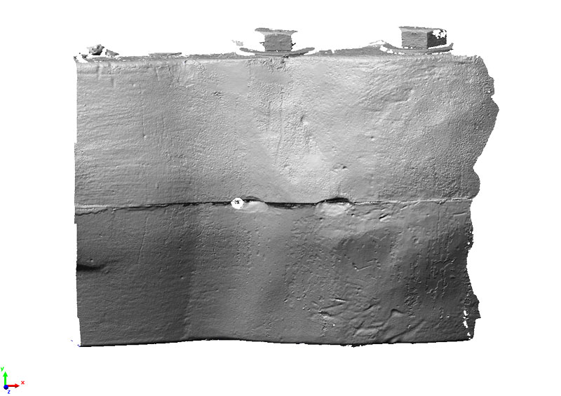

The QuantumSScanarm, outfitted with a FAROBlu™ Laser Line Probe HD high-definition camera, uses the most advanced complementary metal-oxide semiconductor (CMOS) technology to deliver fast frame rate (the number of times per second that the camera gathers new data on the part being scanned) of up to 300 frames per second.

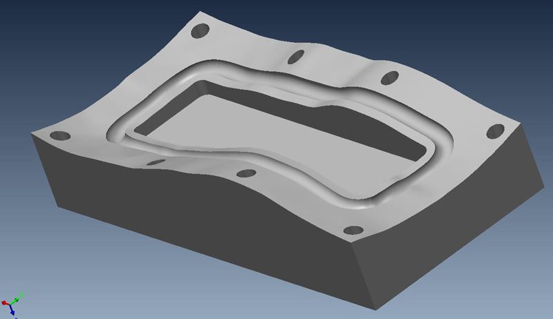

The reverse engineering model was prepared with STL data and CAD geometry.
“We call it a hybrid model,” explains Bonner. “This process saves time because we don’t have to actually surface all of the undulating surfaces of the of the split line. We just pulled the STL off of it and then used Polyworks and SolidWorks to create our model around that portion of the affected area.”

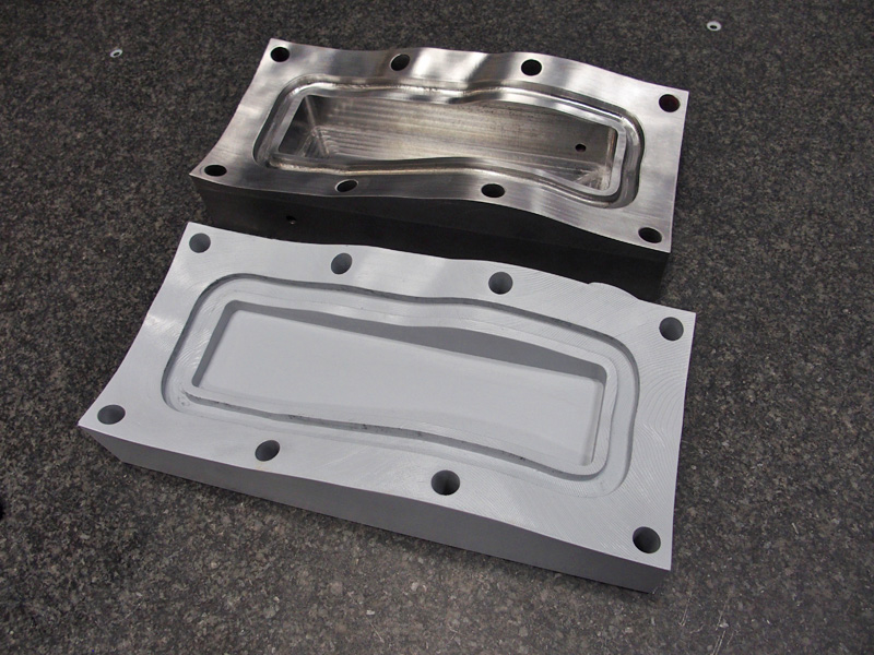

The model data were sent to a 3D printing facility, where a prototype of the clamp was created.

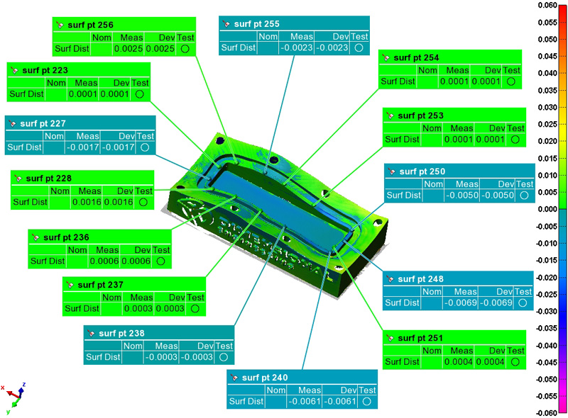

“We went back to the client’s facility and put the model onto the split line, and it fit like a puzzle piece!” says Bonner. “When the final stainless-steel clamp was machined, we scanned it and overlaid that data with our CAD geometry, completing a final inspection in that way.”
