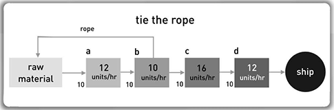

“Tying the rope”, as defined by Eliyahu Goldratt, essentially means that we don’t release raw materials, work orders, or other information to the beginning of the process at a faster rate than the process constraint can handle. This has some similarities to creating “pull” in lean processes. One of the chief sources of distraction that takes people away from the schedule is when they have many choices for what to produce next. By definition, there can only be one optimal schedule to best use the constraint.
Figure 1: A representation of a simple process
