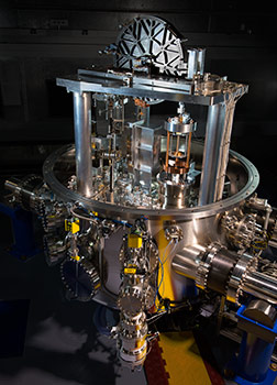

A high-tech version of an old-fashioned balance scale at the National Institute of Standards and Technology (NIST) has just brought scientists a critical step closer toward a new and improved definition of the kilogram. The scale, called the NIST-4 watt balance, has conducted its first measurement of a fundamental physical quantity called Planck’s constant to within 34 parts per billion—demonstrating the scale is accurate enough to assist the international community with the redefinition of the kilogram, an event slated for 2018.
The redefinition—which is not intended to alter the value of the kilogram’s mass, but rather to define it in terms of unchanging fundamental constants of nature—will have little noticeable effect on everyday life. But it will remove a nagging uncertainty in the official kilogram’s mass, owing to its potential to change slightly in value over time, such as when someone touches the metal artifact that currently defines it.
