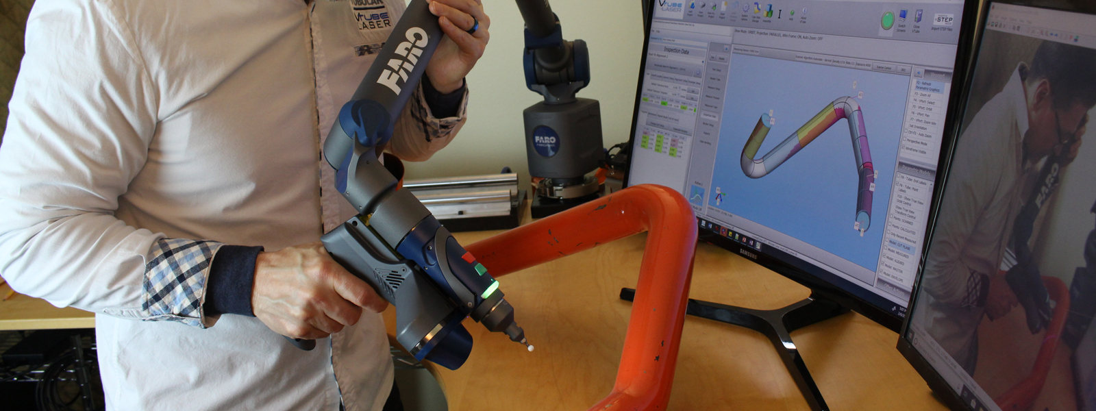

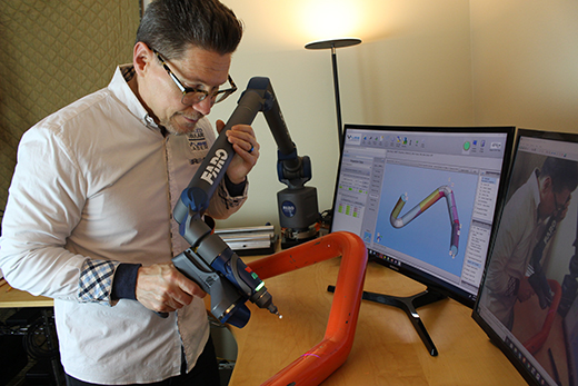

The new gold-standard in engineering is the model-based definition (MBD) method. MBD relies on laser scanners and software capable of leveraging its unique advantage of gathering massive amounts of measurement data.
“Tube fabricators now have the option to use an articulated arm [and laser scanner], like the FARO QuantumS ScanArm, coupled with VTube-LASER software,” reveals Cone. “They can now scan a [first article inspection piece] and compare it with a virtual gauge on-screen. They can see if and where a part is outside of a tolerance envelope, and that information is in the form of data. That data go to the bender, and the next piece is ready in minutes instead of hours. Manufacturing reps see this technology and say, ‘Wait, we’ve been doing this manually for years, and it’s cost us two to four hours every time. Now we can do it in 15 minutes?!’ They start scrambling for funds to buy one of our systems because they understand the ROI immediately. It’s very powerful when they see they don’t have to guess anymore.”

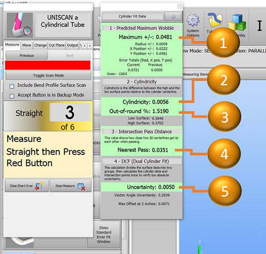

With the VTube-LASER system, scan data are transferred seamlessly to VTube software, streamlining operations with much fewer steps to completion.
“I had a FARO account manager tell me, ‘I measured a tube with two of your competitors’ software,” boasts Cone. “With one, the job took me 75 button presses, with the other it took me 175 button presses. I just went and measured the same tube with VTube-LASER, and it took me only five button presses. I'm sold.’”
