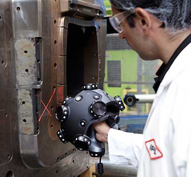

Later on came portable CMMs, which introduced freedom of movement to the concept, but failed to eliminate some of the drawbacks—such as setup rigidity, which is inevitable to measurement accuracy with this type of device. In the case of portable CMMs, both the device and the part require environmental stability because both entities are considered as one rigid body during the measurement process.
https://lh4.googleusercontent.com/TaGcz2Yhu246CenRYf0PGVvm6NjawjjoVnLbzcjmDWRSZFO2Hs7T0SWKUIJpE098tUVvwPXcGYBYR2uLYZkBNdBUXczr71DA0EF7GpRhq19ttzUGTNQ
The HandyPROBE portable coordinate measuring machine (CMM)
