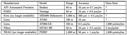

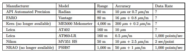

For example, laser trackers and total stations are typically specified for use as a conventional laser-based spherical coordinate measurement system complying with ASME B89.4.19, ISO 10360-10, and ISO17123-5 standards.50–52 These tests are not particularly useful for the NDT community. By providing more useful information about the existing instruments, the NDT community could start learning about the instrument capabilities, writing grant proposals, and performing simple proof-of-principle experiments, with little initial investment by the instrument manufacturers.
The weak link in the 3D coordinate measurement is the angle measurements. If one assumes an instrument will only be used as a conventional single instrument in a 3D coordinate measurement system, there is no need to publish specifications for the distance meter portion, apart from the angle measurement limitations.
If, on the other hand, one were to have an application that lends itself to measuring in only the radial direction, for a 1D measurement, or use a combination of instruments in a trilateration architecture for a 3D measurement, the uninitiated may be led to believe that the range for commercially available instruments is limited to the published 3D specifications, and incorrectly assume the measurement cannot be performed with the instruments available. For example, as shown in table 1, the range specifications for present-day commercially available laser trackers is between 80 m and 160 m.
Table 1. Range and accuracy for laser trackers. Click here for larger image.
However, we know this is an artificial limitation. The Kern ME5000 Mekometer,53–55 which is no longer commercially available, has a range of 4,000 m56 with a single prism. Moreover, the ME5000 Mekometer was a revolutionary innovation in dimensional metrology and found many uses—even though it only measured range, i.e., it did not track and lock onto a target to measure the angles. While commercially available total stations can measure similar ranges, they do not have the same accuracy as the ME5000 Mekometer, nor do they have the accuracy of modern laser trackers.
An instrument with the radial distance accuracy of a laser tracker, and an extended range greater than 80 to 160 m would have applications in NDT—even without the angle measurements. This could be an improved accuracy total station, or an extended-range laser tracker—although the distinction between the two has narrowed, since the introduction of the Leica AT401 in 2010. In particular, a range of as little as 1,000 m would probably cover most civil-structure applications.

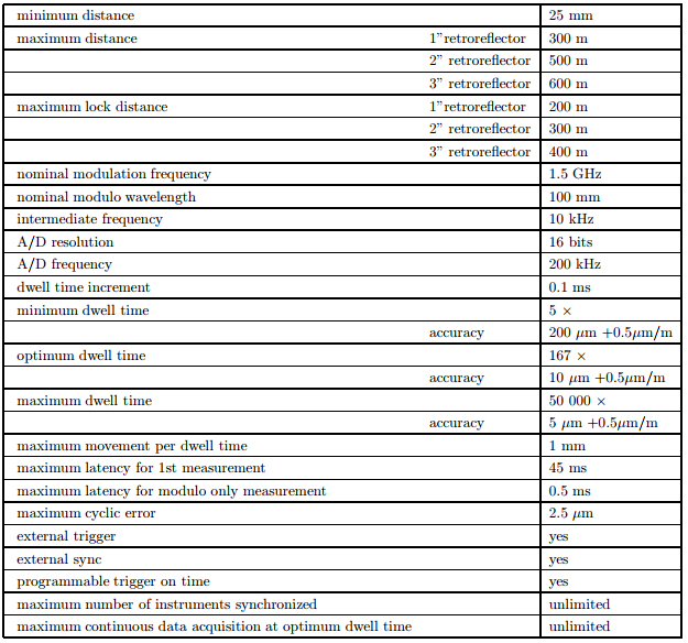

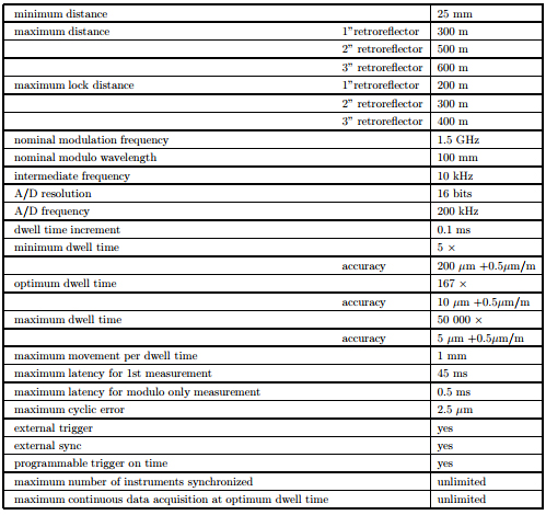

Table 2 shows information that would be useful for an engineer designing an experiment using a laser tracker distance meter. The list and values are merely exemplary and may depend on the architecture of the instrument, e.g., pulse vs. phase measurement. Most of the items are self-explanatory, but some are not obvious.
Table 2. Example radial distance measurement specifications. Click here for larger image.
Some instruments have a minimum distance requirement. The maximum distance may depend on the return power, so it may depend on the retroreflector size. Even if the angle measurements are not to be used, one needs to know the maximum distance the servo will lock onto the retroreflector in order to maintain a strong return signal.
For a phase measurement system, one would like to know the nominal modulation frequency, i.e., the frequency at which the laser is modulated for the most accurate measurement, as opposed to the temporary frequencies used to resolve the initial absolute distance ambiguity. This determines the nominal modulo wavelength over which the phase is measured.
The return signal is typically mixed down to an audio frequency intermediate frequency (IF) for the phase measurement, i.e., the frequency of the signal at the A/D converter. A series of samples are made synchronously for each period of the IF, which are used to calculate the phase, using a digital signal processing technique.66–69
For example, if the IF is 10 kHz and it is determined that 20 samples should be made over the period of one cycle, the sampling frequency would be 200 kHz.
Depending on the signal-to-noise of the instrument, and the atmospheric turbulence, a series of periods are averaged to determine the phase. The dwell time must be integer multiples of the period of the IF, so for an IF of 10 kHz, the dwell time increment would be 0.1 ms. Other dwell times must be integer multiples of 0.1 ms. For example, the minimum dwell time may be five times the dwell time increment, or 0.5 ms. For enhanced accuracy, the dwell time may be increased to average out noise. For example, it may be useful to average over multiples of 16.67 ms in order to reduce 60 Hz noise. Of course, that would limit the vibration frequency being measured to under 30 Hz.
In some cases, it may be more useful to specify the maximum movement ∆r between sequential measurements ∆t to a fraction of the nominal modulo wavelength, e.g., 1 percent.
For NDT applications, it may be desirable to measure a plurality of targets attached to the structure by switching rapidly between the targets in a sequence. For example, measuring 10–20 targets per second. When switching to a new target, the instrument typically switches through a series of modulation frequencies to resolve the absolute distance ambiguity, which is a maximum latency for the first absolute distance measurement. However, for quasi stationary targets, such as on a bridge, there is no need to repeat the full ambiguity measurement every time the instrument switches to the target, so the instrument can make the first measurement immediately after switching with a much shorter maximum latency. For some measurements, the experimenter may only be interested in the AC component and there is no reason to make the absolute distance measurement at all.
There is typically a small cyclic error due to multiple reflections back from the instrument to the retroreflector.56,70 For some experiments, data acquisition may need to be synchronized to an external trigger and multiple instruments may need to by synchronized so the IF signals are synchronized. Some experiments may want to preprogram the data acquisition based on absolute time.
