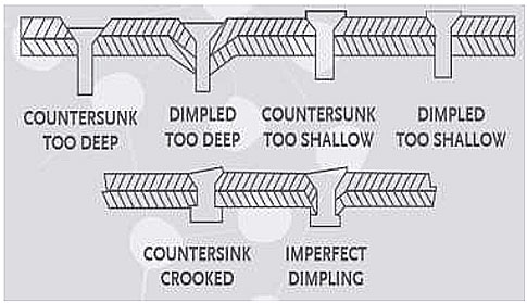

This article is about how augmented reality (AR) techniques can change the way we use measurement equipment. Three applications are presented to demonstrate how much easier, faster, and more intuitive an inspection task gets through gesture control (GC) and presenting information on the inspected surface.

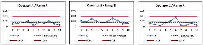

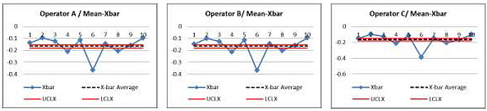

We demonstrate these principles using a fastener-flushness measurement system for the aerospace industry as an example. A gauge repeatability and reproducibility (gauge R&R) test proves that results are repeatable and reproducible, meaning there is very little operator variation. This has been and still is a big problem when using manual dial gauges for the same purpose.
