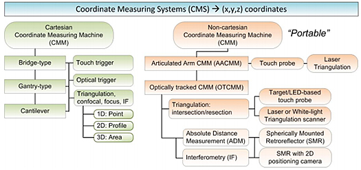

Classification of CMS
The term CMS is proposed to describe any measurement system that generates triplets of (x, y, z) numbers or three-dimensional (3D) coordinates that represent a surface of an object. These coordinates are acquired by touching the surface (contact probing) or by a light-based technique (i.e., noncontact probing). Contact probing is typically used on a CMS with a small sphere attached to a stylus. Noncontact measurement is achieved using light-based methods such as lasers or white-light projectors. Using optical triangulation, a laser beam can produce a set of 3D coordinates, or a point cloud, which contains millions of 3D coordinates (Hocken and Pereira, 2011, Luhmann et al. 2013, Pears et al. 2012).
Many classifications exist depending on user applications and preferences. Here we propose one classification that divides the different techniques into two main categories: Cartesian and non-Cartesian machines. Figure 2 shows the classification and terminology proposed in this article. Most of these CMS are covered by many documentary standards published by ISO, ASME, and VDI/VDE. Noncontact 3D imaging systems are included in documentary standards but consist of acceptance and reverification procedures that follow their contact-based systems counterparts, often neglecting their imaging properties (Beraldin et al., 2015).
Figure 2: Proposed classification of CMS divided into contact and noncontact methods.

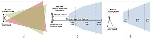

Figure 3: Schematic diagram on the plane showing the field of view of an OTCMM based on two array cameras: a) top view, b) top view showing the results of the intersection of the cameras’ field of view, c) the side view. (Not to scale)

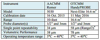

The two portable CMS tested are listed in table 1 and the reference artifacts are itemized in table 2. Only the main data from the calibration certificate are listed. The two physical standard lengths (0.9 m and 2 m) are cantilever ball bars fitted with kinematic seats (see figure 4b). A ring gauge and an aluminum casting were added to simulate normal parts measured on a shop floor.
Table 1: List of instruments tested with some of their characteristics.

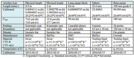

The reference artifacts listed in the table 2 were measured either in an accredited laboratory in accordance with standard ISO/IEC 17025:2005 or at NRC’s NMI at close to 20°C. This environment is not typical of a shop floor; hence, artifacts need to be corrected for thermal expansion at nonstandard temperatures. The standard length is given by equation 1:
where Lm is the measured length at temperature T, α is the coefficient of thermal expansion (CTE) of the artifact and ΔT is given by (T-20°C). Although this equation seems to indicate that all the factors are constants, this is not the case. Two important sources of uncertainty need to be computed to estimate the uncertainty of the length correction (Doiron and Stoup, 1997).
Table 2: List of reference artifacts with some of their characteristics.
The first one comes from the temperature measurement uncertainty, u(T) and the second from the lack of knowledge of the real CTE, u(α). Other sources of uncertainty include probing error and error of indication of size (ISO/TS 23165:2006). The standard uncertainty of the probing error (rigid mounts), u(P), is seen in equation 2:
where F is the form error and u(F) is the standard uncer1tainty of the form error from the calibration certificate. The expanded uncertainty U is k x u(P) where k = 2. The equation for the standard uncertainty of the error of indication for size, u(E), is seen in equation 3:
where is the calibration error from the certificate, is the error due to the input value of the CTE, is the error due to the input value of the temperature, is the error due to misalignment, is the error due to fixturing. Two different environments were selected for the tests: laboratory and shop floor. In the laboratory the temperature is maintained at 20º C ± 0.1º C with a relative humidity (RH) of 40 percent to 50 percent year-round; however, we turned off the air conditioning to simulate a rising temperature and variable RH conditions. During the tests the temperature varied between 20º C and 28º C. The second environment was located in the main NRC development shop floor where prototypes are built. The temperature in this location varied between 22º C and 23º C with a lot of air flow and uncontrolled vibrations. An unstable cart (the four legs are not exactly the same length) held the reference artifacts and an artificial source of vibration was used to simulate more realistic situations. Experience shows that in industrial environments some parts are measured directly on shipping crates or wooden pallets. For the tests, the operator was trained by an expert over a period of two days with both systems. The operator performed three repetitions and the maximum value is reported.

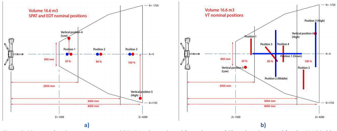

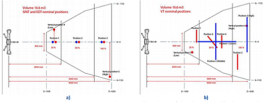

Figure 5: Diagram showing a measurement OTCMM volume viewed from the top: a) Three locations used for the SPAT in blue and five positions for EDT in red, b) Positions of the length artifacts, short length in red and long length (2 m bar) in blue. Click here for larger image.

Single-point “articulation” performance test (SPAT)
Figure 5a shows a diagram illustrating the three positions of the kinematic nest for the Creaform system. The Romer system was tested according to B89.4.22-2004. The Creaform OTCMM model (16.6 m³) was selected to match the spherical measurement volume of the Romer AACMM as closely as possible. To simulate the “articulation motion” as per B89.4.22-2004, the contrast-target based probe on the Creaform system was placed in different orientations. The interface software informed the operator when the probe was out of range. Dynamic compensation mode was not used. In table 3, we see that the result tends to increase with distance. This is to be expected from a photogrammetric system because the magnification changes with distance. In table 4, we see that the SPAT results tend to be better in the middle 80 percent.

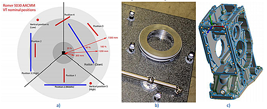

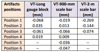

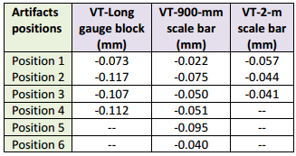

Volumetric performance test (VT)
Here we deviate from the prescribed number of test lengths listed in current standards. The long length (2 m nominal) was not tested in the vertical mode because of the high uncertainty from the calibration certificate (table 2). The standard uncertainty of the error of indication of size is calculated with the characteristics listed in table 2 and equation 3. With the long gauge block we get U(Eh) ≈ 0.007 mm, for the nominal length of 900 mm in horizontal and vertical positions we get U(Eh) = U(Ev) ≈ 0.008 mm, and for the 2000 mm length in the horizontal position we get U(Eh) = 0.013 mm. The long gauge block and 900 mm scale bar are shown in figure 4b along with the mounting of the cantilever scale bars. The main source of uncertainty from the long gauge block originates from the uncertainty in the CTE and the temperature variation. For both cantilever scale bars, the calibration process is the main source of uncertainty. The volumetric performance test results are given in table 7 and table 8 and the diagrams on figure 5b and figure 6a.
Table 7: Volumetric performance test for the OTCMM. Temperature varied between 27.3° C and 27.9° C.
Table 8: Volumetric performance test for the AACMM. Temperature varied between 27.6° C and 27.8° C.
Care was taken to fix the length artifacts on rigid mounts and CTE corrections were applied. The long gauge block was probed with twelve points on each side and two plane equations were fitting assuming parallelism. The scale bars were probed with a 0.5 in. hemispherical anodized-aluminum ball stylus for both CMS. The results indicate again negatives errors for the OTCMM (see table 7). We could not see any trend due to distance between length artifact and optical tracking unit and its orientation. For the AACMM, the results indicate errors that are centered on zero for the short lengths but all negative values for the 2-m scale bar.
Figure 6: a) VT tests equatorial slice of the volume of the AACMM, b) Ring gauge, c) Aluminum casting.

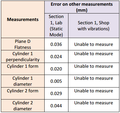

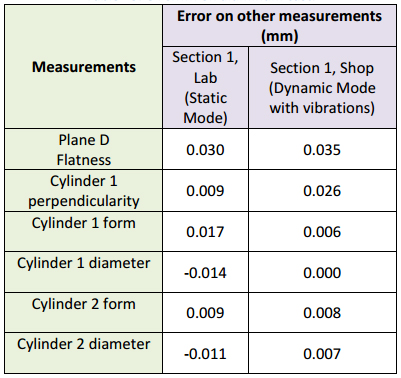

On the aluminum cast shown on figure 1b and its CAD model on figure 6c, several features were measured and some results are listed the following two tables. Entries marked “Unable to measure” indicate that many attempts were made to measure these features using the AACMM but the vibrations were too high to obtain any meaningful results. The OTCMM appeared to outperform the system that lacked motion-tracking capabilities.
Table 13: OTCMM on aluminum cast.
Table 14: AACMM on aluminum cast.
