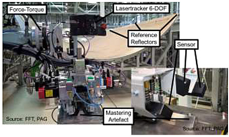

The system concept for stringer integration uses a robot system to lift a stringer from a magazine and transporting it to the integration position. One robot has an end-effector (Schaafhausen, et al., 2013) and moves along the stringers sequentially at the integration points. The partial activation takes place by means of a defined heating. The handling robots hold up the stringer in the non-integrated part and ease the alignment by the end-effector. The manual alignment of the stringers by the workers is simulated in the end-effector by a ball-supported guide system. The rollers are in contact to the stringer to align it. A measurement-assisted integration with a CAD-supported programming method ensures the traceable execution of the processes. A laser tracker with T-Mac (Leica AT901-XR) is used for the geometric compensation of the robot deviations (Schönberg & Wehn, 2014). Depending on the production rate, two laser tractors can be used in the system, which are interchangeable with existing trackers in the factory.
The thickness tolerance of the skin fields and the deviations of the devices do not permit a purely geometrical regulation of the integration process. The pressure of the stringers on the skin field before the partial activation by the descent of a heat accumulator is monitored by a force torque sensor. This clears the end-effector and determines the effective force in the TCP. For the calibration, the transformation of the T-Mac relative to the TCP is determined by reference points at the end-effector, which then touches a stringer defined as origin on a calibration station (as seen in figure 2). The guidance system is checked with light-section sensors. The position of the stringer in the longitudinal direction is monitored via a light-section sensor, too. This is calibrated at a reference edge and observes the cutting edge of the stringer at the interface. After calibrating the end-effector, the tracker is referenced in the section coordinate system. The base and tool transformation of the robot relative to the shell and to the TCP is determined by means of a pendulum program. At the same time the calibration of the force sensor is updated (Schönberg & Wehn, 2015a).
In the integration process, the force control determines the lowering of the stringer until the process force is reached. The geometrical control regulates the remaining 5 degrees of freedom. Once the integration point is reached, a correction with subsequent control is carried out. If the stringer is in tolerance, the integration process is started. On both stringer feet, the heat accumulator is pressed with the process force. The heat accumulator takes over the force of the end-effector. The integration points are finished sequentially. The two sides of the system are locked when using a single tracker. For two trackers, the system works collision-proof locked in parallel (Schönberg & Wehn, 2015b).
Figure 2: Laser tracker guidance at FFT14

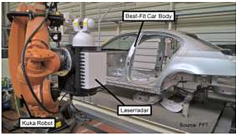

Laser radar
Two frequency-delta-modulated laser beams are backscattered from the measurement object surface and used by the laser radar for the detection of length and velocity (Slotwinski & Blanckaert, 2007). A polarization splitter couples the laser beams into fibers in the reference path as well as in the optical system with a scanner (Sebastian, et al., 1994) or deflection mirrors (Goodwin, et al., 2014) so ​​that they can be evaluated with detectors via a digital signal processor (Slotwinski, 2006). The length measurement is influenced by coherent noise, speckle, and drift of the reference length, (differential) Doppler effects in motion (the mirror) and the coherence length of the laser diode (Economou, et al., 1986). For the detection of reflecting spheres, the signal quality of the laser radar is used for the measurement, which is proportional to the coupling efficiency (Smith, et al., 2015). Angular deviations of 7 ppm and length deviations of 10 microns + 3 ppm are assumed for laser radar.
The noncontact measurement with laser radar must correlate with KMG's tactile strategies, which is not necessarily the ideal measurement strategy. Laser radar provides the following modes:
• Scanning of a surface for the collection of point clouds, which are then paired in the processing chain with CAD geometry. The determination of the measurement characteristics is determined on the basis of the displacement. The intersection of the measuring beam with the desired geometry results in parallax errors.
• Measurement of features with adapted scans, which are calculated directly and, if necessary, refined by further scans. For measuring surface points, the projection to the target geometry or the intersection with a target vector is calculated in addition to the actual impact point and the normal to the surface.
• Measurement of specular objects (mostly tooling balls) by maximizing the coupling efficiency (Smith, et al., 2015). A direct alignment of the measuring beam with the laser radar using the internal logic increases the speed and robustness. In theory, tracking can be implemented in this mode.
• The bidirectional use of the same path through the measuring beam allows the use of mirrors or measuring by transparent materials. The change of the optical path must be compensated for the determination of the measurement results when measured by a glass window (Hadjimichael, et al., 2010) or by a headlamp of a car (Nikon, 2014a).
Laser radar offers high speed due to the noncontact measurement, avoids manual set-up time, and supports absolute measurements. For the positioning of laser radars, robots, linear axes, or rotary tables can increase the visibility for the inspection and in line measurement of body parts. Compared to conventional CMMs, an increase in the measuring speed is approximately one order of magnitude (Nikon, 2016b). The integration of inspections and measurements into the line is possible due to the further development of speed and robustness. The integration by the SDK is implemented for the provision of feature extraction and extensions by means of a client (as seen in figure 3) for the administration and the provision of the functionality.

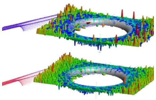

Round features may have threads that affect the surface of the cylinder by helical edges and grooves. These have a defined position along the cylinder axis and can therefore be detected by the laser radar by fine-tuning (as seen in figure 6 ). Compensation is possible for feature extraction and increases precision and robustness. Due to the possibility of the iterative approach by the programmable laser radar, adapters which are desirable or necessary, in particular during the pre-processing and in the line-integrated measurement can be omitted.
Figure 6: Threaded stud feature refinement

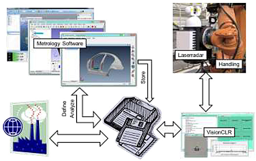

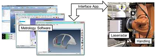

LVM is controlled via an interface application from universal metrology software (as seen in figure 7 ) such as PolyWorks, SpatialAnalyzer, or Metrologic, and then used in a user-guided or programmed sequence for recording and direct evaluation. Further developments lead to fully automated measuring systems with laser radar which function independently via a connection to the process control controller and the robots or axes involved. In essence, the universality of the measurement program is retained, which is user-friendly as far as possible, in particular for a human user and for the device-independent operation. An optimization to automated autonomous operating concepts and manufacturer-specific adaptations are complicated and therefore usually uneconomical. The system is optimized within existing limits and adapted to the tasks and requirements, however, basically used according to manual specifications.
Figure 7: Manual use of laser radar

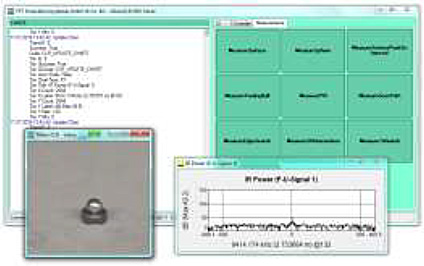

FFT uses an approach using a self-programmed interface to enable measurements with laser radar industrially and to draw the greatest possible benefit from the systems used. The direct connection to the laser radar is carried out via a C# application (VisionCLR, as seen in figure 8), which works with the native SDK of the company Nikon Metrology and is further developed in a close partnership. The feature extraction is available as a plug-in in VisionCLR, but can also be used for diagnostics with stored data. The feature extraction is adapted to the requirements of the manufacturer, so that no external restrictions are introduced during operation due to the introduction of the laser radar and the measurement history for the evaluation and derivation of production strategies is not interrupted. The robots involved are addressed via sensor interfaces in order to avoid a new parameterization of the software or new calibration procedures even in the case of program changes.
Figure 8: Automated use of laser radar
The management of the measurement plans/measurement reports, the connection to the process control, the manual parameterization and the introduction of quality measures are carried out by a C++-based control software. It manages the machine state, assigns the measurement orders to VisionCLR, accepts the results of the measurements, and ensures that they are processed correctly. There is also a connection to the metrology software described above, which accesses the data of the FFT systems via a plug-in system and can perform the validation and parameter settings via the available functions. This approach provides for the application of the existing knowledge from the metrology software, but uses the extended possibilities of interface software specially developed for the automated measuring process.

For industrial use, the laser radar offers different scenarios and integration degrees due to its high flexibility. In principle, the distinction can be carried out in relation to the location of the measurement at a separate location (off-line) in the line as a single station or by-pass (in-line) or process-integrated (in-process).
Off-line solutions are located in a measuring room or in a separate place in production, but without linking. Typical tasks are analysis measurements of components, assemblies, or subassemblies which for larger components have a feature count in the order of 2,000. The use of laser radar significantly reduces the measurement times so that a larger number of vehicles can be measured on fewer measuring plates. The complete measurement of a vehicle, including a change, within an hour, is the aim. This requires a reduction of the measuring time per feature and the intelligent compilation of measurements. Since the positions of the features in the analysis measurements require many positions for the laser radar, reduction of referencing time is also important. The positioning of the laser radar is often achieved in a measuring space by a combination of rotational axes for the object to be measured and vertically arranged linear axes since these can also be safely designed for humans and no separations are required as with robots.
In-line solutions test the vehicles within the linking of the system and give a direct feedback on the current state with the possibility of initiating quality-enhancing measures directly. Since the cycle times are generally less than one minute and only a few minutes are available for a bypass, fewer features are measured (count in the order of 200) and these are often distributed in a ring strategy. To keep the number of characteristics to be measured as high as possible, the reference can be carried out outside the main time. Typical scenarios for in-line stations use several laser radars that are mounted either stationary or on linear axes. This ensures the visibility of the measurement characteristics and the measurement time is reduced by duplication.
In-process solutions integrate laser radar into the assembly process through a measure-motion-measure strategy. Thus the laser radar is a critical component and requires reliable availability and the development of emergency strategies for failure. Since, in most cases, a complex joining process is part of the assembly process within the station, the cycle time loss to be tolerated is very small (within 5–15 seconds). This is a major challenge for the laser radar due to the single beam, and can only be achieved by a model-based compensation strategy that is used to validate the model at the start of the process. The remaining cycle is used to update the model. For in-process solutions, the laser radar is not moved within the cycle, but it may also be necessary to use other positions to support or optimize multiple types.
