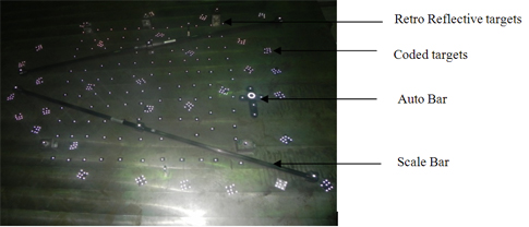

Case study 1
Aim: Before measurements on the actual reflector were conducted, an experiment was carried out on a flat bed (i.e., a CMM bed). The measurement was carried out on a set of retroreflective targets stuck on the specimen’s surface (i.e., the CMM bed) by using two independent measurement techniques (i.e., CRP and the CMM). Initial 3D data of these points were computed using CRP, and then further CMM measurement was carried on the same x and y coordinates of the targets. The results thus obtained were compared to check the z coordinate deviations.
Figure 2: Measurement set for CRP
Test setup

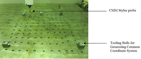

To obtain a common coordinate system that can be measured by both CRP and CMM, a magnetic V-block was kept on the surface plate (as seen in figure 2). Over the edges of the V-block, spherically mounted retroreflectors (SMR) were stuck using an adhesive that provides a bond strong enough to handle the retroreflective spherical balls (SBR) as well as the impact force that comes during replacement of SBRs by CMM-compatible spherical balls, in addition to the impact force which comes during probing by the CMM.
A total of six such SBR and SMR assemblies were used to generate a coordinate system.
111 points were stuck on the surface plate (as seen in figure 3). The tip of the CMM stylus was a sphere made of artificial ruby with a diameter of 3 mm. The CRP target was probed, and the CMM stylus made a plane with three points. In addition, a normal to the plane was found so as to go to the exact x, y, and z locations as prescribed by CRP. This further reduced the error due to pre-travel variation.
Figure 3: CMM measurement setup

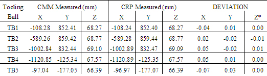

1. Tooling ball measurement comparison by the two techniques:
*z coordinate is the out-of-plane coordinate axis.
2. The transformation of the coordinate systems made with the help of tooling balls gave an RMS of residuals as 32 microns. It gives the best fit of the two coordinate systems (as seen in figure 4).

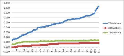

3. Further, the flatness of the CMM bed was computed by both the techniques. The determinant for comparison was the RMS of the two planes:
• CMM = 0.025 mm
• CRP = 0.032 mm
The point-to-point comparison shows that variation for z deviation lies in the range of 14 microns to 83 microns, which gives a very close match between CRP and CMM measurements (as seen in figure 5).
Figure 5: Point-to-point comparison of the 111 points measured by the two techniques, sorted in smallest to highest values.

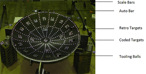

Aim: A similar exercise as explained in the first case study was undertaken, with the only difference being that the new test setup was to measure a 0.9 m parabolic antenna (as seen in figure 6).
The objective of this study was to establish the correlation and nearness of the measurements taken up by two different techniques via CRP and the CMM on a curved surface.
Figure 6: CRP measurement setup for 0.9 m parabolic dish
Test setup
Approximately 400 retroreflective targets were stuck on the antenna surface. These were subsequently measured by CRP. A total of six SBR and SMR assemblies were stuck on the periphery of the antenna. A common coordinate system was established using SBR and SMR. The tip of the CMM stylus was a sphere made of artificial ruby with a diameter of 3 mm. The CRP target was probed, and the CMM stylus made a plane with three points. In addition, a normal to the plane was found so as to go to the exact x, y, and z locations as prescribed by CRP.
Figure 7: 0.9 m antenna reference frame (Image from V-Stars software, Geodetic Systems Inc., www.geodetic.com.)

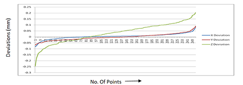

3. The point-to-point comparison shows that variation for z deviation lies in the range of –245 microns to +203 microns, which gives a very close match between CRP and CMM measurements (as seen in figure 9).
Figure 9: Point-to-point comparison measured by the two techniques, sorted in smallest to highest values.
4. Statistical analysis of the measured data to see the spread of the data:

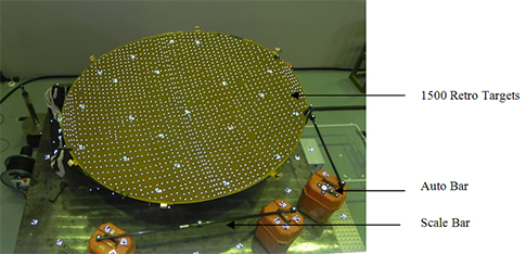

Approximately 1,500 retroreflective targets were stuck on the reflector (as seen in figure 11). Scale bar and auto bars were kept to appropriately scale the measurements. To generate a common coordinate system, six tooling balls were stuck using an adhesive all through the periphery of the reflector. These tooling balls had an interface to suit both the CMM spherical balls and CRP-compatible, retro spherical balls with the same offset.

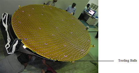

The first measurement was done using the CMM (as seen in figure 10). A coordinate system was established using the tooling balls.
Subsequently, the tooling balls data were used as nominal data by the CRP software. CRP measurement was then completed and the transformation using the tooling balls was done to arrive at the same coordinate system as that of the CMM. These data were then given to the CMM, which used the x and y coordinates as input to probe the z coordinates for all the 1,500 points.
It took six to eight hours for the CMM to measure the points, whereas it took only 1 hour by CRP (including processing) to give the coordinate values. This is an important aspect to be considered when measurements inside a thermo vac chamber are to be done. Even if it would have been possible to make measurements using a CMM inside the chamber, it would have taken almost six times longer to finish just one set of measurements.
Figure 10: Shaped reflector ready for CMM measurement (reference establishment)
Figure 11: CRP setup of shaped reflector measurement

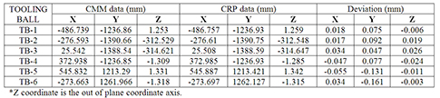

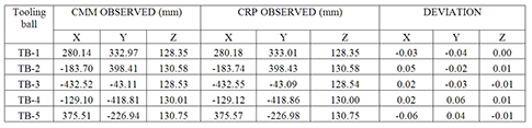

2. The transformation of the coordinate systems made with the help of tooling balls gave an RMS of residuals as 32 microns. It gives the best fit of the two coordinate systems (as seen in figure 12).

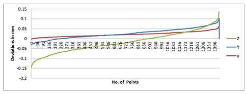

3. The point-to-point comparison (as seen in figure 13) was as follows:
For x deviation: The point-to-point comparison shows that variation for x deviation lies in the range of –3 microns to +63 microns, which gives a very close match between CRP and CMM measurements
For y deviation: The point-to-point comparison shows that variation for y deviation lies in the range of –29 microns to +39 microns, which again gives a very close match between CRP and CMM measurements and is within the transformation values.
For z deviation: The point-to-point comparison shows that variation for z deviation lies in the range of –114 microns to +31 microns, which again gives a very close match between CRP and CMM measurements and is within the transformation values.
Figure 13: Point-to-point comparison on reflector measured by the two techniques, sorted in smallest to highest values
Statistical analysis of the spread of the data for z deviations:
