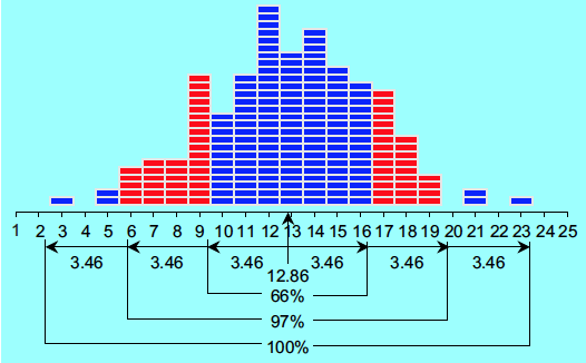

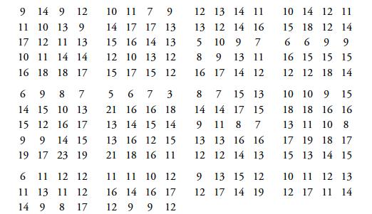

The data in Figure 1 are 200 sequential values obtained over time from a single process. The average is 12.86, and the standard deviation statistic is s = 3.462. The histogram is shown in Figure 2.

To do this, we use a test developed and published by Brenda Ramirez and George Runger in 2006. The test statistic compares two different measures of dispersion. The first of these is the standard deviation statistic computed using all of the data. The second of these is the average of the differences between successive values. Here, the time order is given by reading the data in rows. Figure 3 lists the 199 successive differences.
The average of these 199 successive differences is 2.42.
Average successive difference = 2.42

These data are not sufficiently well-behaved to be represented by a single probability model. However, that doesn’t keep your software from drawing a bell-shaped curve over the histogram as in Figure 8.
Ramirez-Runger tells us that, regardless of how pretty Figure 8 may look, there are only 13 chances in a billion that it’s correct. A more realistic representation of the process that produced the data for Example 1 would look something like Figure 9.
