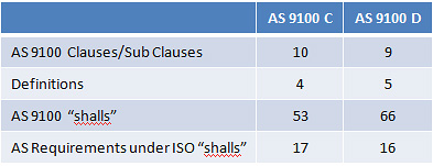

AS9100 Rev. D is built on a base of the recently revised quality management system standard ISO 9001:2015. The drivers of AS9100 Rev. D are the changes found in ISO 9001:2015, along with aerospace additions and other IAQG standards. When AS9100 Rev. D is compared to AS9100 Rev. C, it’s evident that the number of additional “shalls” in AS9100 Rev. D is 66 vs. 53 “shalls” in AS9100 Rev. C. (See figure 1 below.)
There are nine subclauses in AS9100 Rev. D vs. 10 subclauses in AS 9100 Rev. C. There are two new subclauses in AS9100 Rev. D, which are 8.1.3—“Product safety” and 8.1.4—“Prevention of counterfeit parts.” However, 30 percent of the additional “shalls” were in “Measurement, analysis and improvement” in AS9100 Rev. C, and only 3 percent were in “Performance evaluation” for AS9100 Rev. D.
