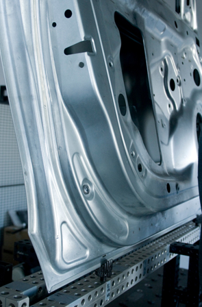

Figure 1 part with a typical surface finish to be scanned in the project

  • An essential requirement of the project was to scan the aluminum and galvanized steel surfaces of the automotive parts without any pre-scanning treatment, such as applying anti-reflective coating. Therefore, the system had to cope with highly reflective and shiny areas on the scanned parts.

All aluminum parts (hoods) and galvanized steel parts could be scanned without prior treatment or spraying. In some cases problems were encountered when the hall lights were mirrored on a surface. This resulted in missing point data in this area.
Figure 1010. The door handle area on a shiny galvanized door is almost completely captured, without preparation of the surface.
