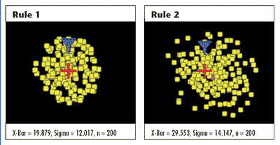

By adjusting the process to X-bar, Ring illustrated rule No. 2 of W. Edwards Deming’s “funnel experiment,” which demonstrates natural variability in a process by using a funnel to drop a marble on a target. If the funnel never moved, these marbles would reflect variation because no two would fall in exactly the same position.
If, on the other hand, the funnel is adjusted after each drop, the process would reflect increased variability. What Ring is doing reflects rule No. 2: “At drop k (k = 1, 2, 3…), the marble will come to rest at point Zk, measured from target. Move the funnel distance -Zk from its last position.” (See Deming, W. Edwards, Out of the Crisis, MIT Press, 1982.) Following this rule will increase process variability by approximately 50 percent.
The figures below demonstrate the variability found in Deming’s funnel experiment.
