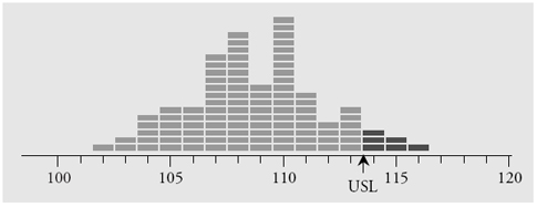

In order to make the following discussion concrete, we will need an example. We shall use a collection of 100 observations obtained from a predictable process. These values are the lengths of pieces of wire with a spade connector on each end. These wires are used to connect the horn button on a steering wheel assembly. The upper specification for this length is 113 mm.
https://lh3.googleusercontent.com/1eqkRppiAo0mCAUeLQPPdPhr13d8U95uwiXAL9ZzPtn5bAUeTLiOh2462LdAY3AzI2BguOxQDp-9v662HuG8XnLP9XUWz9Oji6nw4EkAWAMJPTBgT3g
Figure 1: Histogram of 100 wire lengths
