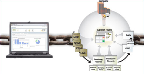

Integrated receiving and inspection tied to supplier rating
In the dynamic and complex environment of supplier management, there are many touch points in which supplier goods must adhere to your quality standards. From receiving and inspection to nonconformance and deviation, it is important to maintain the highest level of quality from your suppliers.
In many systems, these elements are dispersed among several business systems (e.g., materials requirements planner, enterprise resource planning, quality management systems) with little to no integration. The result is an inconsistency of data, often relying on manual methods to effectively track the supplier relationship from receiving to production. Having a singular, integrated, and automated system to track supplier goods from start to finish is vital to creating traceability in the quality system and accurately determining the overall supplier rating.
Look for a system that not only automates the quality process with respect to positioning defective supplier goods, but also automates the receiving and inspection process. There is often a data gap between when supplier goods are received and inspected, and when a defect is found and the quality process takes over. This disconnect can result in critical gaps in identifying the lots, materials, samples, and other details related to the defective goods. This can affect the overall supplier rating and may result in a double entry of defects to the supplier’s rating profile.
Having a system that handles the receiving and inspection as well as the nonconformance, deviation, and corrective action processes is key to successfully tracking supplier quality. By integrating these elements into a holistic system, supplier quality is tracked seamlessly throughout the entire life cycle of the supplier goods as they enter your system. Furthermore, this integration automatically provides traceability into the supplier’s goods, and provides an accurate method of building the supplier rating in real time.
Tracking supplier goods from receiving to production
As supplier goods are shipped to the warehouse, they are tracked in a receiving record. The receiving department will determine the correct quantity and whether an inspection is needed. Inspections often follow a specific protocol unique to suppliers and supplier goods, and have unique sampling plans and specifications associated with them. In an integrated system, this is automatically determined and triggers an inspection record, with all the relevant data regarding that particular inspection such as skip lot profiles, supplier profiles, sampling plans based on acceptable quality levels, and more. The results of the inspection will determine the quality of the goods provided, and will affect the overall supplier rating. If an inspection fails, the system should automatically trigger a nonconformance and look for any planned deviation records corresponding to the goods. If there is a planned deviation, the goods are used as is; if not, then a nonconformance disposition type is determined and reviewed by a material review board. This can result in a supplier corrective action, updates to the supplier rating, or risk-based analysis on the supplier goods.
With real-time visibility, suppliers can partake in the corrective action, fulfilling their part of the investigation, without any bottlenecks associated with communicating the investigation. They can simply log into your QMS using limited access, and see which corrective actions are assigned to them. A corrective action that is drafted can be addressed within your company as well as to your suppliers on the same day it is issued. This eliminates the administrative overhead in seeking out the supplier’s processes and communicating offline about the issue.
Supplier ratings are affected by the quality of goods provided. The supplier rating is automatically updated in real time as the goods are delivered, received, inspected, and processed. This automation eliminates any mishandling of qualitative data related to the supplier rating and streamlines the entire process of supplier management to the quality system. As a result, processes associated with quality are directly and automatically inherited into the supplier rating. This data are now added to the supplier scorecard, which is made visible to the supplier.
