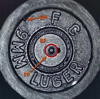

Cartridge cases—the empty shells left behind after a gun is fired—are routinely sent to forensic laboratories for analysis when they are found at a shooting scene. Using a specialized microscope called an integrated ballistic identification system (IBIS), lab technicians acquire digital images of three markings, or “signatures,” impressed on the cartridge case by the gun that fired it. These signatures—the firing pin impression, the breech face impression, and the ejector mark—are unique when fired from a specific firearm and can serve as “fingerprints” for that gun once the digital images are entered into a national database known as the National Integrated Ballistic Information Network (NIBIN).

This cartridge case shows the three distinct marks, or “signatures,” impressed on its surface when it was fired by a gun: the firing pin impression (FP), the breech face impression (BF), and the ejector mark (EM). NIST’s standard casing ensures that forensic labs can accurately match signatures on shells found at crime scenes with images in a national database. Credit: NIST
