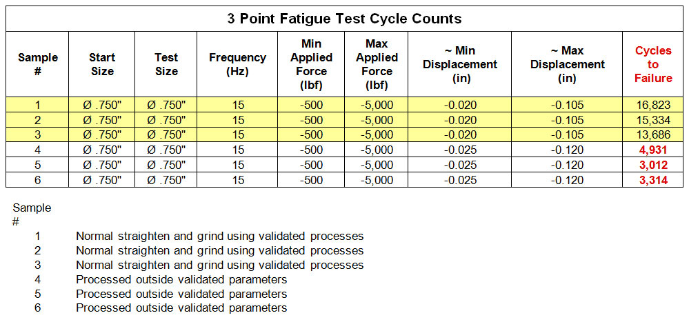

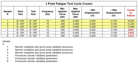

For a worst-case scenario on straightening, grinding, and turning processes, bars were processed outside validated parameters. Then the supplier removed 125 percent of the routing parameter; for example, if the router states 0.010 in. removal, Banner tried to remove 0.0125 in. per grinding pass. Banner also ground samples down to 15 percent of the original diameter by volume. Samples were taken for analysis on surface condition, mechanical properties, and straightness (TIR).
Extensive and detailed protocols determined the effectiveness of equipment function, operations and processes, outputs, and revalidation criteria. Hundreds of samples were sent to a third-party A2LA and NADCAP-accredited laboratory (Exova) for analysis. Multiple samples for each scenario were run and analyzed for repeatability and reproducibility.
The tests concluded that, operating within validated procedures and processes, Banner could produce material that was compliant in terms of mechanical properties without adverse effect on the raw material. Removing 85-percent volume of stock, and straightening 20 times has no negative impact on physical properties and surface conditions, as long as validated processing parameters are followed. Operating outside of the safe zone of validated protocols, processes, and parameters, Banner found adverse impacts on final produced materials.
Click here for a larger image.
Figure 3: Figure 3: Third-party NADCAP-acredited lab analysis. Click here for a larger image.
For example, per the test performed on a 0.750-in.-diameter, implantable-grade titanium ELI ASTM F136 bar, results showed that excessive straightening could induce surface cracks. Although there was no significant change in the physical properties before and after the test, under dynamic loading (fatigue test), the fatigue cycles were reduced by a factor of 5 when operating outside of highly controlled and proven processes (see figure 3). Application life under validated processes averaged about 15,000 cycles, but failure occurred within 20 percent of that application life, at about 3,500 cycles, with processes outside these parameters.
