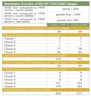

• Users familiar with ISO/IEC 17025:1999, but not with ISO 9001:2000, might find the apparently large number of changes in ISO/IEC 17025:2005 overwhelming (as seen in the figure below). The best way to address this is to either compare the old and new versions of ISO/IEC 17025 to identify what really changed or obtain your accreditor's guidance on the changes. Users who aren't accredited could review the members list at www.ilac.org to find accreditors from their countries, and then consult these accreditors' Web sites for information, identify accreditors from Quality Digest's online database or simply visit the public pages at www.a2la.org.

During the development of ISO/IEC 17025:2005, much copyediting and some shuffling of subclauses occurred along with the few substantive changes noted below. General changes included an introduction to customer focus, more definition of top management's responsibilities and the identification of internal communication needs. It should be remembered that standards reflect minimum requirements. Some supplemental accreditor requirements or customer-specific activities--automotive "layered audits," for example--might apply to specific laboratories. Other items in the standard may prove sufficiently useful for implementation as a common practice for more robust systems. However, it's your decision as to which added requirements are appropriate beyond specific accreditor and customer contract requirements.
The specific intended changes are:
• 4.1.5 is added and requires that personnel be aware of the relevance and importance of their activities and how they contribute to achieving the objectives of the management system.
• 4.1.6 is added and requires top management to ensure that appropriate internal communication processes are established and the management system's effectiveness is communicated within the laboratory.
• 4.2.3 is added, repositioning the old 4.2.3 into the new 4.2.5, and requires top management to provide evidence of its commitment to developing and implementing the management system and continually improving its effectiveness.
• 4.2.4 is added, repositioning the old 4.2.4 into the new 4.2.6, and requires top management to communicate the importance of meeting customer as well as statutory and regulatory requirements.
• 4.2.7 is added and requires top management to ensure that the management system's integrity is maintained when changes are planned and implemented.
This could prove troublesome because ISO/IEC 17025's language arises largely from ISO/IEC 17000 and VIM, which use the terms "plan," "planned" or "planning" sparingly. A little common sense could help avoid a lot of tension created by a too-literal interpretation of this requirement.
• 4.10 is added, repositioning the old 4.10 into the new 4.11, and requires the laboratory to continually improve the effectiveness of its management system through a quality policy and objectives, audit results, analysis of data, corrective and/or preventive actions, and management review.
This requirement could be greatly simplified if laboratories voluntarily adopted the measurable objectives of ISO 9001:2000 while satisfying ISO/IEC 17025:2005's clause 4.2.2. Labs might use descriptive directional goals or targets instead of specific numerical targets that encourage unnecessary statistical game-playing and "managing by imaginary numbers," as W. Edwards Deming termed this fairly common, nonvalue-added exercise.
• 5.9.2 is added and requires that quality data are analyzed and planned action taken when data are found to be outside predefined criteria.
