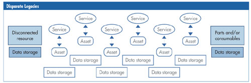

Shifting focus from task to asset
Although most legacy software systems on the factory floor focus on repair, changeover or calibration, it's important to remember that an "asset" is the core element, and service and support tasks are merely activities or events that contribute to documenting the overall cost of ownership, system governance, maintenance and compliance programs.
Companies invest millions of dollars in assets for production facilities, including manufacturing machinery, test equipment and human capital. Consolidating real-time and historical
service data from the disparate software systems that manage assets can help optimize an organization's potential in the following ways:
• Increase production volume predictability
• Reduce machine downtime and increase productivity
• Synchronize activities to decrease redundant costs
• Increase turns of mission-critical parts inventory
• Reduce standing parts and consumable inventory
• Reduce redundant software and database systems
For example, if a specification or work instruction is required to perform a task within one system, it shouldn't require re-entry or manual cut-and-paste to another application database to make it visible to that application. Common procedures and specifications should reside in one place and be available to all other applications that need that same data. Cost savings can be realized by eliminating redundant data-entry operations as well as by increasing data reliability.
By consolidating redundant information and selecting software systems that track activity-based costs around the asset itself rather than the type of work being performed, an organization will increase cost-reduction opportunities across multiple disciplines in the asset-management process. The company might actually reduce the number of software applications, databases and administrative resources required to maintain a healthy asset program.
From a software-technology perspective, the process required to keep tactical assets of any type available and functioning are basically the same, regardless of the type of service or support activity being performed. The process includes:
• Identifying the physical asset that requires service activity
• Specifying the activity to be performed and who shall perform it
• Providing the task-specific information required for success
• Providing necessary supplies and/or equipment
• Managing the information and/or resources during the process
• Documenting the process and assessing related effects
• Analyzing opportunities to prevent negative recurrences
The more asset life-cycle data are centralized and made available to all support personnel, the more efficiently they can assess a situation and execute their duties based on facts. This results in a positive, cost-effective outcome.
Lab and calibration systems, for example, don't always have access to preventive maintenance or line-changeover schedules. The lack of manufacturing visibility to the calibration lab prevents it from easily synchronizing calibration schedules to minimize equipment downtime and avoid duplicate or redundant effort for activities that could have been scheduled concurrently.
When internal facilities operate as suppliers or customers of one another, it's good business to synchronize preventive downtime across facilities to avoid soft spots in production performance that could affect other facilities' production capability, delivery and profitability.

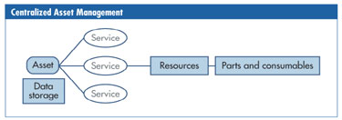

Focus on the basics
Before considering any new software solution, you must first understand your asset management requirements across the entire organization. For each type of asset (e.g., equipment, gage, personnel, vehicle, etc.), you must address the following:
• Asset tracking. Where will the organization manage and track data about a particular asset? What's the primary information system (i.e., application) used to manage this asset? Is this system capable of maintaining the overall asset life-cycle management data?
• Operations and service . Review each
service-and-support software system for data and compliance requirements for internal governance, customer audits and regulatory issues. Focus on redundant data elements and administrative tasks, and develop open architecture that allows for easy data exchange with other third-party applications. This is a key to reducing administrative redundancy on the factory floor.
• Systems that support services . Create an environment that will promote
"enterprise-asset awareness" vs. departmental ownership. Think outside the box (or department) and analyze service inventories by use, owner, location and critical response requirements such as maintenance or changeover consumables, tooling and equipment standards used for calibration. Separate the more predictable services from those that are ad hoc, critical and unpredictable. The goal is to automate events that can be eliminated from the administrative workflow and thereby reduce resource drain.
