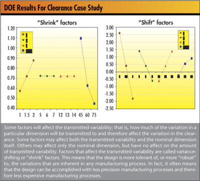

A manufacturer of portable power tools wishes to improve customer satisfaction with a certain tool by reducing the amount of noise generated during its operation. The designers have determined that a primary source of noise is bearing slap in the conversion of rotary to reciprocal motion. The design change is intended to reduce this clearance. When presented with this task, most designers intuitively observe that the clearance can be reduced by increasing the ball diameter, decreasing the angle of the raceway, increasing the width of the slider or some combination of these three. Without understanding the relationships embodied in the transfer function, however, these conclusions will lead to a less-than-optimal solution.
From the geometry shown on the drawings in the figure to the right, the designer was able to describe the clearance between the ball bearing and the slider dimensions in terms of the components’ dimensions. Using this approach along with DFSS tools, a solution was found that simultaneously achieved the desired target for the clearance and minimized the inherent variability from the manufacturing process.
That solution called for a reduced ball diameter (a), an increased raceway angle (a) and increased raceway width (b). The underlying reasons for this can be seen in the analytic description shown in the figure below. All four factors have an effect on the clearance, but two of them affect variability as well. The optimum design strategy used the “shrink” factors to reduce the variability and the “shift” factors to put the design on target. This case illustrates that design solutions to reduce variability often aren’t intuitive and are missed in the traditional design focus on achieving a single-point design.
