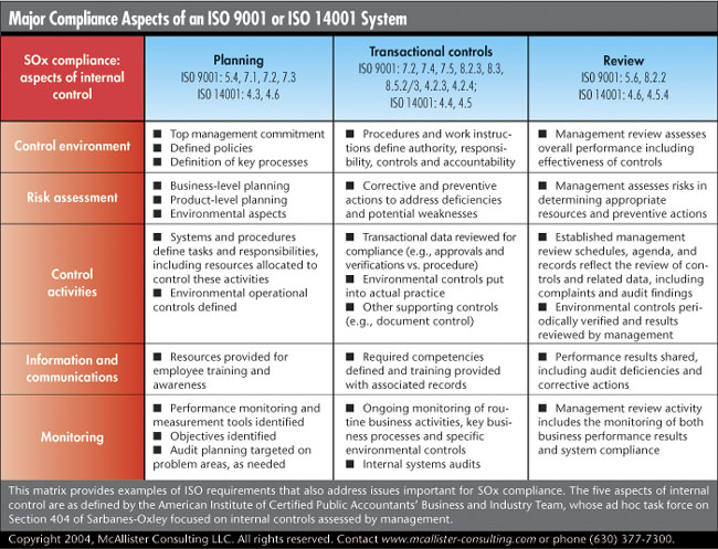

ISO 9001 and ISO 14001 are natural vehicles to help achieve and sustain SOx compliance. To understand the connection between ISO standards and SOx requirements, we’ll look at the macro-level similarities and some examples. (See figure below.)

There are five components for assessing internal controls as required by the statute’s section 404. These are identified in the Internal Control-Integrated Framework report developed by the Treadway Commission’s Committee of Sponsoring Organizations (see www.cpa2biz.com). The components are:
Control environment
Risk assessment
Process control
Information and communications
Monitoring
Compliance to ISO standards contributes, in some measure, to all five components of internal controls. For example, ISO 9001 emphasizes the importance of clearly understanding and communicating customer and regulatory requirements, and ensuring that this information is shared by everyone involved in meeting those requirements. ISO 9001 also emphasizes monitoring product, processes and environmental controls. Risk assessment is a factor for both ISO 9001 and ISO 14001 compliance. For ISO 9001, planning for the quality system and the products it produces necessarily involves risk assessment. For ISO 14001, an organization must specifically identify environmental aspects and proactively minimize potential risks. In addition, the control environment is directly affected by ISO standards. The culture that contributes to ISO compliance also lends credibility to SOx’s section 404 assessments and attestations.
