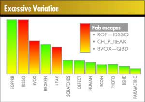

A Pareto chart of the reasons for failed wafers at electrical test identified three process modules that showed excessive variation in the fabrication process. These modules included the spacer formation, channel implants and post-implant acid cleaning steps. Other suspect areas, identified during the team’s brainstorming sessions, were eliminated by performing commonality studies on past events, discussing the issue with industry experts, and re-evaluating experiments that had been previously run.
