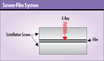

During the next half-century, X-ray technology--although constantly refined--didn’t change drastically. X-rays were emitted from a source, passed through an object and detected either on film or a fluorescent screen. Contrast and spatial resolutions improved, as did film speeds and control over X-ray sources. Scintillation screens were also used with film to achieve better images at lower dosage.

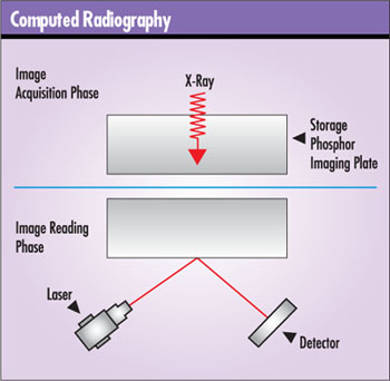

With the introduction of computed radiography during the 1980s, a giant step forward for X-ray imaging occurred. Until this time, the technology’s analog nature prevented any real automation. Inspection, defect recognition, sorting and the like depended upon human interpretation of film or image-intensifier images. Computed radiography offered the benefits of computer-aided image enhancement and recognition, the ability to store and transmit digital images, and the elimination of film processing and all its associated costs.
Computed radiography works similarly to film-based X-rays, but instead of X-ray film, a storage phosphor screen is irradiated and the latent image stored within it. It’s then taken to a reader, which uses a laser and detector to scan the latent image from the screen. In most cases this technology can be easily retrofitted into film-based systems, eliminating the need for film, chemicals, processing lab, equipment and storage.

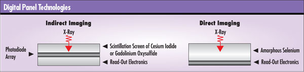

During the late 1990s, digital flat panels were introduced. Unlike their film or computed radiography predecessors, they provide digital readout of an X-ray image, making it possible to automate X-ray NDT inspection. Except for the fact that they can’t be cut or bent, digital flat panels are used in much the same way as film or computed radiography and can be left in place while robotic or conveyor systems bring parts to them or reposition parts for multiple views. The operator doesn’t have to change film or storage phosphor plates between shots, and the X-ray image is available seconds after it’s acquired, greatly improving on the productivity offered by film or computed radiography systems.
Currently, two digital flat-panel technologies are battling head-to-head for the market: amorphous selenium (a-Se) and amorphous silicon (a-Si). Outwardly, they both function in the same manner: X-rays are picked up by the panel, which converts them into a digital image that can be read from the plate. Because the panels require no processing, images can be obtained at rates of one image every few seconds up to live video speeds of 30 images per second. Because of their better resolution and increased field of view, flat panel displays with 30 images-per-second speed are ideal replacements for image intensifiers. However, depending upon the manufacturer, the 30 image-per-second frame rate may come at the cost of decreased resolution.
With amorphous selenium technology, X-rays strike an a-Se layer, which converts them directly into an electric charge that’s further converted to a digital value for each pixel. This is called a direct-imaging method. Proponents of a-Se say it offers better spatial resolution than a-Si.
With what are commonly called amorphous silicon panels (a misnomer because even a-Se panels use amorphous silicon), X-rays first strike a scintillation layer. This layer emits photons in direct proportion to the energy of the X-rays striking it. The photons are picked up by the underlying a-Si photo-diode matrix, which converts them to an electric charge. This charge is then converted to a digital value for each pixel. Because of the intermediate step of converting X-rays to light via the scintillation layer, this is called an indirect-imaging method. The scintillation layer is commonly composed of either cesium iodide or gadolinium oxysulfide, with CsI being the preferred material. Proponents of a-Si panels say they offer much faster frame rates, up to 30 images per second, than a-Se panels.
Both technologies offer near-film spatial resolution but with contrast ranges far exceeding film.
