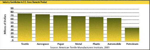

                            fiber, textile and apparel industries account for about 7 percent of all manufacturing jobs in the United States. Combined, these industries employ 1.2 million people directly and support more than 2.4 million other
                            jobs. This massive industrial complex is the largest contributor among basic manufacturing industries to the U.S. gross domestic product.  During the past 10 years, textile-related industries have invested more
                            than $2 billion annually in new technologies and equipment. This investment has driven remarkable productivity increases. Productivity in weaving per loom hour, for example, increased more than 500 percent between 1975
                            and 1999. This sharply contrasts with overall U.S. manufacturing productivity, which has more than doubled since 1970.1

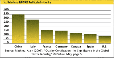

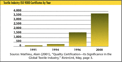

                             The textile industry, especially in the United States, has recently begun to use the ISO 9000 series of standards as a quality assurance system, though registration is still seen by
                            many companies as only necessary as a factor for exports. Ten years ago there were fewer than 100 textile companies registered. By 1996 the number had soared to 1,600,
                            and by the end of last year, there were 3,673 registered textile companies.  The number of ISO 9000 certificates in the textile industry increased 29.6 percent from
                            1998 to 1999. China, Italy, France and Germany lead the world in numbers of certified textile companies, whereas only a few of the more than 30,000 U.S. companies have been registered.
                             With the publication of the ISO 9000:2000 revision, more textile companies will likely find value in using the standards as the basis for their quality assurance systems. Also, an
