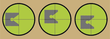

                                                    comparators is their ability to measure in 2-D space. Unlike micrometers and calipers, which measure one dimension at a time, comparators measure length and width simultaneously. To do this, the
                                                    operator lines up the lower left-hand corner of the image with the screen centerline to establish a zero point, as illustrated above, and then checks the upper right-hand corner to get a
                                                    simultaneous reading of both length and width. The straight-line distance from corner to corner can be obtained with a single keystroke.
                                                    Measuring Length and Width
                                                     In addition, constructed points, gage points or gage lines that appear on part drawings can be established quickly on optical comparators, making relative measurements from
                                                    these "points in space" easy to perform. This technique is illustrated below. The right side of the part is aligned with the vertical centerline, and a zero position is set. The part
                                                    is moved to the right by the nominal depth given on the drawing. A diameter is then measured at this depth by moving the part vertically and measuring points on each angled surface. "Points in Space" Measurement

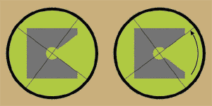

    Measurement by screen rotation. Another early measurement technique still
                                                    performed with optical comparators is rotating the screen to measure angles. Similar to measuring with chart gages, measuring angles is still quick, simple and highly effective.
                                                    Vernier scales provide angle measurements when rotating the screen ring. In recent years, digital rotary encoders have eliminated the need for vernier scales, making angle
                                                    measurements even easier. Angles are digitally displayed in 0.01-degree increments. The screen ring is rotated (as shown on page 32) so the centerlines are aligned with the
                                                    first edge, the angle display is zeroed and the screen is rotated and aligned with the second edge. The angle between the two edges is digitally displayed in the LCD window.
                                                     Screen-ring calibrations can minimize thermal effects and ensure accurate angle readings. These calibrations can be performed in seconds by rotating the screen 360
                                                    degrees and entering a compensation factor, if needed.  Measurement by Screen Rotation

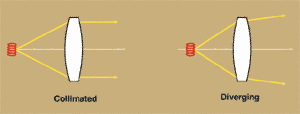

                                                     Illumination systems incorporate collimator lenses that collect light from the source and project it onto the part. By projecting parallel light rays across the part, collimator
                                                    lenses can improve image quality and reduce the adverse effects of stray light rays that cause halos and blurred edges. An illustration on page 32 shows the desirable light rays
                                                    from a collimated light source compared to a light source with diverging light rays that could produce unclear images.
                                                     Collimated- vs. Diverging-Light Sources
