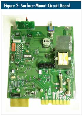

D-M-E circuit board using a surface-mount design rather than the more traditional through-hole configuration, which is not WEEE-compliant.

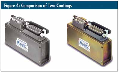

When shown side by side, the color difference is very clear between trivalent chromium (right) and hexavalent chromium materials.

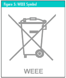

This symbol is on all products requiring proper disposal as named in the WEEE legislation.

For electrical-board layouts, D-M-E had to change from a through-hole to a surface-mount design. With the former configuration, lead components were actually stuck through the circuit board to hold them in place, causing contamination to the solder pot over time. With the surface-mount design solution, lead components sit on top of the circuit board rather than penetrating it, eliminating contamination. As another benefit, surface-mount boards are easier to recycle, facilitating WEEE compliance, as seen in figure 2, right.
The configuration change didn’t completely solve the problem. To create a surface-mount circuit board, components are attached using a solder paste screened onto the face of the board. The board is then moved through an oven to melt the solder paste. However, the high-process temperatures required to melt the paste can cause problems with the components and boards, potentially affecting product longevity.
D-M-E designed a new oven-heating process for adhering components to the electrical boards. Using precise timing and a single pass through the oven rather than multiple exposures to the intense heat, D-M-E ensured proper connection with minimal heat stress to the components.
Another issue the company faced was tin whiskers on its edge-card connectors. On lead-free tin surfaces, tin whiskers may grow long enough to short one electronic circuit to another, causing the product to malfunction. This issue was solved by using hot-dipped plating with a matte finish wherever possible instead of electroplating, because a shiny electroplated finish is most likely to cause whisker growth, as seen in figure 3 at right.
The lead ban also affects solder appearance. IPC has recommended a new solder made of 97 percent tin, 0.5 percent copper, and 2.5 percent silver to comply with RoHS. Manufacturers are concerned because the solder joints don’t look as clean and shiny with this new mixture as they did when using a tin and lead mixture.
Manufacturers should focus on reevaluating old standards rather than trying to comply with them. For instance, IPC has created new levels of acceptability for visual inspection of lead-free circuit boards. The new, not-as-pretty appearance is acceptable until something better is developed.
With electrical enclosures, D-M-E needed to eliminate hexavalent chromium, a restricted material often identified by its yellowish color. The challenge was finding a cost-effective equivalent that offers the same corrosion resistance. D-M-E switched to trivalent chromium, a silvery, compliant material that offers the same level of corrosion resistance and the same cost of plating, as seen in figure 4, at right.

WEEE’s aim is to eliminate air, soil, and water contamination from the hazardous disposal of manufacturing materials and chemicals. Problems such as the one discovered by Erin Brockovich, where water contaminated with hexavalent chromium sickened California residents, would be prevented by this directive.
For manufacturers, WEEE’s compliance challenge is deciding what to do with all the component pieces returned to them. It will probably mean longer-lasting parts as manufacturers do more repairing and less disposing.
Consumer electronics don’t tend to have long life spans. When a $35 CD player dies, few consumers will spend $50 to fix it. Even if manufacturers bear the cost of returning the items for disposal, will consumers actually return them? In Belgium, consumers pay recycling fees up front when they purchase items, and some U.S. computer manufacturers are beginning to do that as well.
Addressing the RoHS side of compliance will help make the WEEE side easier to tackle. As you work to eliminate banned materials from your products, make sure you also consider the WEEE effects.

Reevaluating products for RoHS can also help improve reliability and quality. When D-M-E eliminated hexavalent chromium from its electrical enclosures, it led to an environmentally friendlier alternative that was cost-effective and offered the same corrosion resistance that the product needed.
