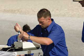

Artel’s extreme pipetting expedition in Death Valley National Park

Mission No. 3: Death Valley
For Mission No. 3, ARTEL went to Death Valley National Park to test the effect of dry and hot environmental conditions on pipetted volumes. Dry heat was chosen as a scientific focus because many laboratory technicians encounter dry conditions due to the type of analytical instruments and other laboratory equipment (such as ovens, incubators, and freezers), and the lack of humidifiers in their work environments.
At Death Valley, ARTEL found that pipettes underdeliver by up to 35 percent in dry and hot environments. While volume-delivery errors were partially reduced by pre-wetting pipette tips, underdelivery still persisted, and the pipettes were found to operate outside of manufacturers’ specifications in most instances.
As found in previous missions, errors were greater when pipettes were set to their minimum volumes than when they were set to their maximum volumes. When working with larger liquid volumes, errors were still induced but were of a smaller magnitude.
Liquid-handling error in dry heat is largely due to evaporation. The evaporation of a miniscule amount of liquid inside the pipette tip has a large effect on pipetted volumes, especially when target volumes are in the microliter range. When one microliter of liquid evaporates, it converts into more than 1,000 microliters of gas, expanding by a factor of 1,250 to 1,450, depending on temperature. This expansion prevents the pipette from aspirating the desired target volume.
Based on the data found in Death Valley, pre-wetting pipette tips at least five times is highly recommended to reduce the error when pipetting in dry and hot environments.
