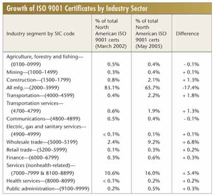

Even looking at the recent past, the shift is visible. Near the beginning of 2002 manufacturing represented about 83 percent of all ISO 9001 registrations in North America, with another 10 percent going to nonhealth care, service-related industries (see figure below). Over the next three years ISO 9001 moved into other industry sectors, particularly in transportation and transportation services, wholesale trade, and nonhealth-related services. Today manufacturing makes up about 66 percent of North American ISO 9001 registrations, with service, the second-largest sector, representing about 16 percent of all registrations.

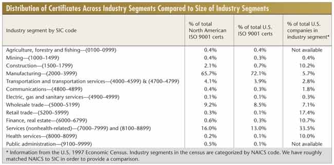

To understand the disproportionate use of the standard in manufacturing, consider the figure above, which shows the distribution of both North American and U.S. ISO 9001 certificates across industrial sectors compared to the percentage distribution of those sectors in the United States (the same data wasn't easily available for Canadian industry).
The figure shows that even though man--ufacturing makes up a relatively small portion of U.S. companies (about 6 percent) it represents 72 percent of all U.S. ISO 9001 certificates. On the other hand, while retail, finance and real estate, and health care combined represent around 38 percent of all U.S. industry, they account for less than 1 percent of certificates.
Where the growth of ISO 9001 in nonmanufacturing industries has been most visible is in nonhealth-related services and wholesale trade companies. Nonhealth-related services make up about one-third of all U.S. business and account for about 13 percent of U.S. ISO 9001 certificates, while wholesale companies represent about 7.1 percent of U.S. business and 8.5 percent of ISO 9001 certificates.
