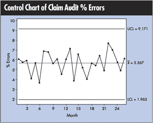

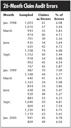

Consider the following scenario. I was consulting for an insurance company where an important quality requirement was the percent of claims processed correctly. An audit department took a monthly random sample of processed claims and reported its result as an overall indicator of quality--a classic use of sampling plans. Moreover, the results of the current month’s sample were used to adjust the sample size for the next month’s audit--rewarding “good” results and punishing “bad” ones.
Twenty-six months of the department’s audit data are shown in the table to the right.
I plotted a simple control chart of the percent of errors and obtained the chart above. Purists, I know, will think I should have done a p-chart. That’s a whole other article, but rest assured the p-chart is stable as well.
The process hadn’t changed in more than two years, and yet the sampling statistics were technically correct. They estimated the current month’s result--no more, no less.
I’m sure a documented standard procedure existed somewhere that required this formal and expensive audit, but for what purpose? It did nothing but waste energy and money to answer the question, “What’s this month’s statistical variation from 5.6 percent?” This energy could have gone toward improving the process, which would require different--and simpler--analytic statistical methods.
I asked what was done with the claims after the audit and was told, “Nothing.” I asked whether the auditors might consider taking the next three months’ worth of claims with errors and perform some type of error analysis. Blank stares were the response. That wasn’t the department’s job. However, the auditors were quite adept at taking that month’s result and calculating next month’s sample size. As W. Edwards Deming would say, “Simple… obvious… and wrong!”
Now, what about the managers who received the audit results? I’m sure they used these results for improvement purposes and to track trends--an incorrect objective, given the way these data were collected.
Did you know that given two numbers, one will be bigger? The key question is, “Is the process that produced the second number the same as the process that produced the first number?” No one had ever charted the results to assess the process, nor could I convince them that it was a useful thing to do.
