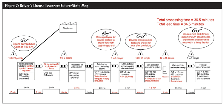

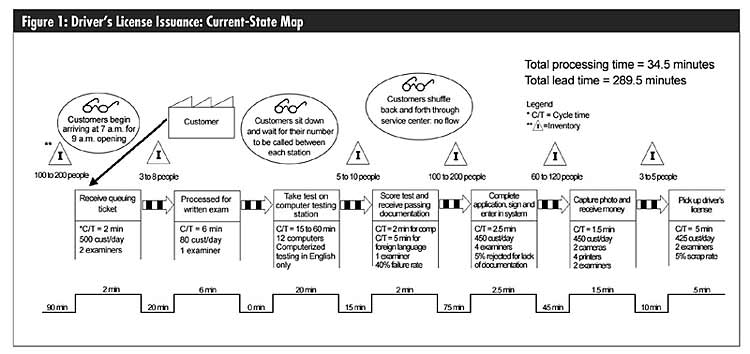

A case study
Figures 1 and 2 depict current-state and future-state examples of how a VSM can be applied in a service industry. In this case, a common service that many of us dread--driver's license issuance--is developed using the flow of a customer needing to take a written test to receive a license. Embedded in this value stream are the basic services of renewal, replacement, and name and address changes.
Following the completion of VSM steps one through five, the team that developed the current-state map brainstormed the following improvement initiatives:
• Develop a creative staffing plan that allows for extended hours to eliminate a deluge at the beginning of the day.
• Develop written instructions in multiple languages detailing exactly the forms and documentation needed for each service a customer may need.
• Redesign the application forms for easier understanding and create a desk with template examples where customers can fill out their own paperwork.
• Create online practice exams in multiple languages.
• To decrease the failure rate, charge for a second test attempt.
• Provide computer-based testing in multiple languages, eliminating paper and pencil testing and manual scoring.
• Install one more camera at the photo station to keep up with demand.
• Develop a first-in, first-out line for photos and license receipt to prevent customers from sitting and returning to the process.
• Redesign the layout of service centers to eliminate confusion and create a continuous flow of customers.
• Create a one-stop help desk for customers who have unusual circumstances so they don't disrupt the flow.
These improvement initiatives are only a few of the ideas developed to improve the value stream for driver's license issuance. There are many small improvements that form during a VSM event that can also be implemented quickly.
Clearly, there are many more options to further improve the future-state map. This future state accomplished two goals of VSM and lean techniques. First, the improvement initiative strategy was created with a six-month time frame and the improvements that were called for were doable in this time period. Second, the team focused on improvements that were of little or no cost. This is a key learning point within lean systems: Avoid significant investment in capital until the process can't be improved without it.
