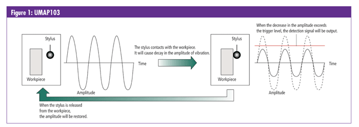

The UMAP vision system from Mitutoyo couples a noncontact vision measuring system with an ultrasonically activated probe. The UMAP103 probe is available with a stylus length of either 2 mm or 12 mm, and a diameter as small as 12 µm. The probe tip ball diameter is 30 µm or 80 µm, and is ideally suited for microhole measurement, according to the company.
"Mitutoyo's development of UMAP resulted from a specific request from Toyota Motor Co. for a probing system able to accurately measure the ports on fuel injection system nozzles," says Frank Demski, a Mitutoyo product manager. "Another requirement came from the fiber-optic connector (ferrule) industry. Medical devices, microelectronics, miniature gears and other micromachined parts are just some suitable applications."
Unlike a traditional touch probe that relies upon deflection to trigger a contact, the UMAP103 depends upon the dampening of an ultrasonic field when the probe comes into contact with an object. As shown in figure 1, the UMAP103 normally vibrates at ultrasonic frequencies at a known amplitude, which is measured by the detecting circuit. As the probe comes into contact with the workpiece, the amplitude of the ultrasonic signal decreases. When the signal drops to a predetermined level, the probe is considered to have touched the workpiece. This means that the contact force is very low, generally around 1 µN.
Mitutoyo doesn't have a volumetric accuracy specification for the UMAP103 probe when used with one of the company's vision systems. Mitutoyo does say, however, that when used in the company's ULTRA Quick Vision platforms, linear accuracies of 300 nm (0.3 µm) are possible, with a repeatability of better than 100 nm.

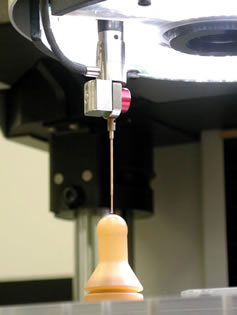

The Feather Probe from Optical Gaging Products uses a miniature probe that's in constant micromotion. Similar in appearance to traditional touch probes, the Feather Probe has a small probe tip (as small as 125 µm) at the end of a very narrow stylus. However, the triggering method is very different. As the tip approaches the object to be measured, its micromotion is dampened by the part surface. This threshold-crossing change in the micromotion is registered as a point measurement. Because there's virtually zero deflection, the potential for shanking error that might occur with a touch-trigger probe is eliminated. The measurement technique is sensitive enough (about 10 µN) to allow measurement of very flexible or deformable materials. The technique works equally well in the X, Y and Z axes.
As with other microsensors, an important consideration for the Feather Probe is the overall system accuracy. For example, coordinate measuring machines (CMM) typically offer large measurement volumes. Designed for use with touch-trigger probes, positioning accuracy in such systems may not be as critical as it is for video measuring systems. The CMM merely has to get the probe close enough for the trigger mechanism to register a measurement. Video measuring systems, on the other hand, have the high-resolution positioning necessary for high-magnification imaging of specific part locations within the measurement volume. These measuring systems are consistent with the high lateral and height-measuring capabilities of microsensors. In other words, microprobing is most accurate when the measurement system on which it is done can deliver specific measurement performance. Video measurement systems, such as those from OGP, have this level of precision.
OGP offers the Feather Probe for its Smartscope Flash or SmartScope Quest products. These systems, equipped with the Feather Probe, excel at inspecting the small bores, channels and orifices of parts manufactured using electric discharge machining.

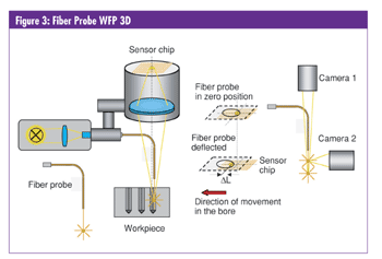

The Werth Fiber Probe WFP 3D has been around for several years but still boasts the smallest probe size--down to 12.5 µm. The spherical glass tip is mounted on the end of a fiber-optic shank that is offered in sizes from 20-200 mm (about 8 in.) long. The length of the shank is limited only by the focal length of the measuring camera.
The probe tip is monitored by a camera. (See figure 3.) The fiber-optic shank and probe tip are aligned near the center axis of the lens. The camera detects the probe tip's deflection as it comes into contact with the work piece, thus indicating a contact. Because of the flexibility and extremely light weight of the probe, the contact force can be as little as 1 µN. Although the fiber-optic shank is relatively flexible, it's rigid enough that the probe always returns to the same at-rest position after it's been deflected.
Because the probe tip must be visible to the camera, illumination is required. The methods of illumination are either a transmitted light mode, where the probe and workpiece are both visible between the light source and the camera, or in a self-illumination mode. In that mode, the fiber-optic shank is illuminated on one end by an LED, and the light is transmitted through the fiber-optic cable to the probe tip.
The Fiber Probe can be used in single point or scanning modes. In scanning mode, it's also capable of surface roughness measurements.
Werth specifies that the Fiber Probe, when used on a Werth Video-Check HA CMM, has a volumetric accuracy of 1.5 µm over a 300-mm diagonal.
