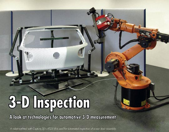

A robot outfitted with Capture 3D's ATOS III is
used for automated inspection of a rear door assembly.
