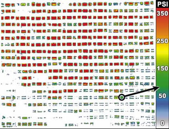

Bryan ordered Pressurex, a thin sensor film that instantly captures and permanently records pressure distribution and magnitude between contacting or mating surfaces. The film measures pressure from 2-43,000 psi (0.14-3,000 kg/cm 2). For his test, Bryan specified the “Super Low” Pressurex product, which measures pressure from 70-350 psi (5-25kg/cm 2).

After the pressing operation, when Bryan examined the Pressurex film, different areas of the film exhibited different intensities of color, with the color changes directly proportional to the actual pressure applied at any given spot on the film. By comparing the color intensity to a color-correlation chart (conceptually similar to interpreting Litmus paper), Bryan was able to determine the precise pressure magnitude at any given area on the film. “I could visually inspect Pressurex and prove that the press plates weren’t flat and were causing uneven pressure distribution,” says Bryan.
The aluminum transfer plates were sent to the machine shop, where they were set up on a surface plate and evaluated for flatness and parallelism. The dimensional results indicated that the transfer plates were, in fact, warped. Revisions were made to the transfer plate design, and new plates made to tighter flatness and parallelism specifications.
Follow-up testing was done with the new transfer plates, and the Pressurex film indicated a dramatic improvement in the overall pressure distribution during the pressing operation. Once the plate parallelism was resolved, the scrap rate during this operation was significantly reduced.

“In this case I sent the exposed Pressurex film to Sensor Products, where they ran it through their Topaq system,” says Bryan. “The exposed pressure-sensitive film is scanned optically, and the software is used to interpret numerous types of statistical information from the high-resolution, color-calibrated image.
“With this information we were able to see the force distribution, the peak force, the total force, the total contact area, the average psi, and the standard deviation. All this information is available in various, easy-to-read two- and three-dimensional formats.”
