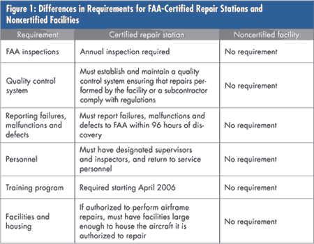

FAA and other national aviation authorities (e.g., NAA) oversight of certified repair stations require a tremendous amount of resources centered around personnel with a high degree of specialized knowledge about manufacturing and repair processes, material technology, regulations, quality control techniques and much more. Like many other federal agencies, the FAA has a limited budget, and the agency is always under public and congressional scrutiny, especially during the aftermaths of aviation accidents. In reports published in 2003 and 2005, the Department of Transportation through the Office of the Inspector General (DOT IG) expressed concerns about the FAA's oversight of the contract maintenance industry and stated that the agency's oversight is currently insufficient for the amount of work independent repair stations perform for airlines.

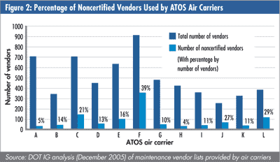

The FAA has responded to these findings, in part, by introducing a risk-based inspection program that identifies those repair stations doing the most work for airlines and monitoring their operations more closely. At present, it is estimated that the FAA has certified close to 4,600 domestic and 650 foreign repair stations. However, in addition to the FAA-certified repair stations, a growing number of noncertified repair stations are performing safety-critical work, according to a December 2005 report issued by the DOT IG. By definition, the work performed by these noncertified repair stations is not overseen by the FAA inspectors. Even though the work performed in such noncertified stations must be performed by FAA-certified mechanics and inspected by FAA-certified inspectors, there is a dramatic difference between the regulatory requirements for certified and noncertified stations, as seen in figure 1 below.

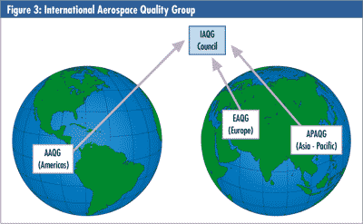

At this time, airline involvement in the AS9110 standard and the ICOP scheme has been minimal. It is expected that some airlines, realizing the potential implications and benefits of invoking AS9110 to their supplier base, might become more involved through the sectorial groups: The Americas Aerospace Quality Group, the European Aerospace Quality Group and the Asia-Pacific Aerospace Quality Group. (See figure 3 below.)
