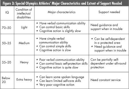

By analyzing the characteristics of different SO athletes, it's possible to identify the extent of support they might need, as shown in figure 3 below.

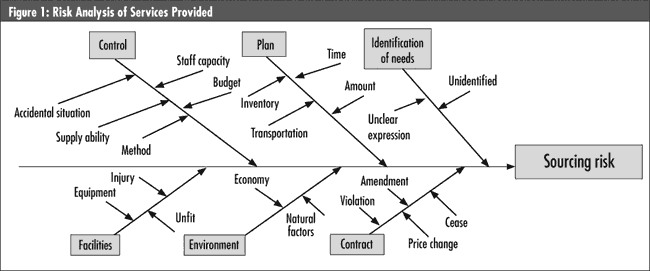

• Risks in providing services . Because of the wide range of services and varied professions involved, risks do exist in providing services during the games. Brainstorming was used to list possible risks and to focus the analysis on identifying needs, planning and quality control.
Existing risks in providing services can be divided into two categories, external and internal. External risks include service contracts, fees and unforeseen risks; internal risks include identifying needs, planning and quality control. Risk analysis provided a foundation for analyzing the potential effects of services on the SO, as illustrated in the fishbone diagram seen in figure 1 below.

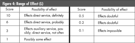

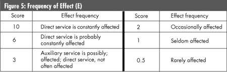

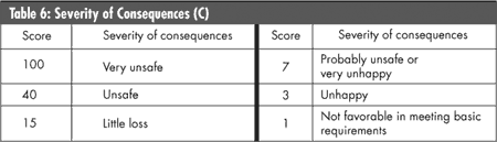

• The effect of service providers on the SO. Because of these potential risks, the SO could be affected if service providers are unable to meet the requirements of the individual services. Because of the scope of services, means, staff, environment, etc., the extent of the effect of service providers varies. The analytical methods of Kenneth Graham and Gilbert Ford Kinney were used to ensure that data were scientific, easy to control and appropriate. A group consisting of experts familiar with the SO's service needs was set up to define the scoring standard. The range of effects (L) is shown in figure 4; the frequency of effect (E) is shown in figure 5; and the severity of consequences (C) is shown in figure 6.

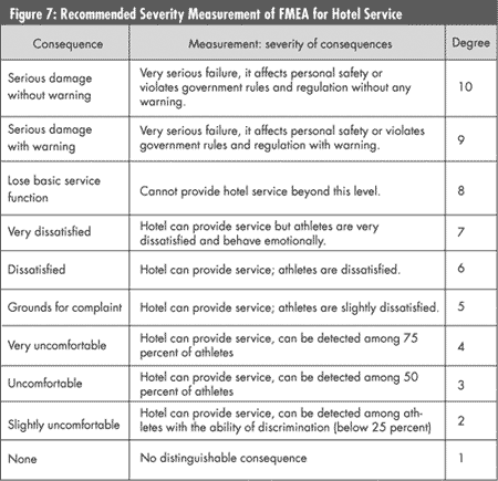

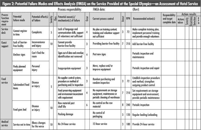

For service levels A and B, which could have serious and moderate effects, respectively, an FMEA should be done prior to performing the service. FMEA measurements should first be set up to indicate severity, occurrence and detection before analyzing the service-providing process. Take the measurement of severity as an example derived from hotel services. (See figure 7.)
Based on established measurements, an example of an FMEA implementation (using hotel service as an example) is shown in figure 2.
FMEA analysis and the results shown in figure 2 indicate that the management of service providers should focus on risk priority numbers (RPN) and severity, and raise improvement requirements for service providers when necessary.

• When the degree of severity ≥ 9 or RPN ≥ 100, and RPN ≥ 200 in two items, corrective actions should be taken and FMEA performed again. Services shouldn't be provided until the requirements are met.
• When 100 ≤ RPN ≤ 200, measures should be taken and service shouldn't be provided until any identified risks are reduced or eliminated.
• When RPN ≤ 100, potential risks by service providers, along with relevant preventive measures, should be indicated in advance.
• For C-level service providers, FMEA isn't required before providing services. However, any potential risks by service providers should be indicated as far as possible.
