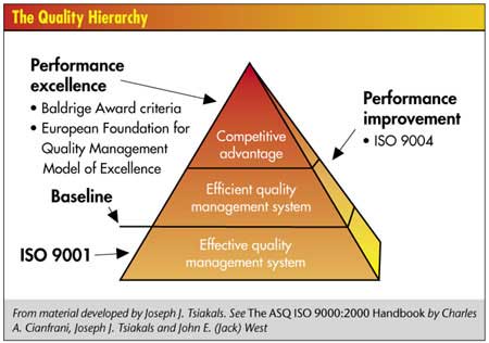

An organization can use ISO 9001 to develop a basic QMS and achieve registration to that standard if desired. Using ISO 9004 together with ISO 9001, an organization can determine the best activities and processes to achieve improvements in performance as well as ensure it meets customer requirements. In theory, conformity to ISO 9001 provides an organization with a basic QMS. ISO 9004 helps the organization make this QMS more efficient and achieve improved results. The concept is illustrated in the figure on the following page and is described in greater detail in Chapter 4 of The ASQ ISO 9000:2000 Handbook (Charles A. Cianfrani, Joseph J. Tsiakals and John E. [Jack] West, ASQ Quality Press, 2001).

ISO technical committee (TC) 176/subcommittee (SC) 2 is now working on specifications for a revision to ISO 9004, which is projected to be issued in 2008. This revision will significantly upgrade the document so that it provides a more comprehensive bridge between ISO 9001 and the assessment criteria of excellence models such as the Malcolm Baldrige National Quality Award. ISO 9004 is a useful tool, and the 2008 version should be even better.
