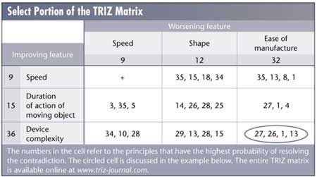

Technical contradictions . These are the classic engineering and business trade-offs in which the desired state can't be reached because something else in the system prevents it. In other words, when something gets better, something else gets worse. Examples include:
 Product gets stronger (i.e., good), but the weight increases (i.e., bad).
 Bandwidth increases (good) but requires more power (bad).
 Service is customized to each customer (good), but the service delivery system becomes complicated (bad).
 Automobile airbags deploy quickly to protect the passenger (good), but the faster they deploy, the more likely they are to injure or kill small or out-of-position people (bad).

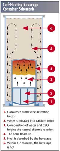

The Wolfgang Puck self-heating coffee can is a recent TRIZ success story. Michael S. Slocum, co-editor of The TRIZ Journal, was the vice president for science and engineering at Ontro (now OnTech), a food technology company based in San Diego. From 2001 through 2003, he used TRIZ, quality function deployment, and axiomatic design and robust engineering to solve more than 400 problems encountered in the development of the self-heating beverage container. This container was named one of 25 hot products to watch by Fortune magazine and then noted by the New York Times. 4,5
A few of the contradictions addressed by the OnTech team included:
Fast heating of the beverage is good, but fast heating of the water--CaO mix creates steam, which can rupture the capsule.
Thin materials are needed between the water-CaO mixture and the beverage for rapid heating, but thin materials aren't strong enough to withstand the pressure created by the process.
Multiple-layer materials are much stronger than single-layer materials, but they're expensive to manufacture.
The customer wants to drink the beverage right away but will be disappointed if the beverage isn't hot.
The top of the can should be metal to make it easy to use a conventional pop-top opener, but it shouldn't be metal to avoid burning the customer's lips.
Clearly, the OnTech team faced a mixture of technical contradictions and physical contradictions. The product's success is a tribute to OnTech's application of TRIZ to the solutions.
OnTech's package development has many examples of the interplay between solving a technical contradiction and a physical contradiction. For example, one difficult physical contradiction is that the outer wall must be thick so that it stays cool and users aren't burned when they pick up the coffee, but the outer wall must be thin so that the contents can be raised to a high temperature quickly during sterilization.
OnTech solved this problem by using six layers of material to separate the properties of the whole and the parts, but that solution created a technical contradiction: The complex six-layer structure was expensive to manufacture, and it was very difficult to get a good yield, especially in the double-seaming step where the edge of the wall meets the top and the bottom of the can. Using the TRIZ matrix (a portion of which can be found in the figure above), which expresses all technical contradictions in tradeoff terms, the tradeoff was:
The complexity of the system improves (Parameter 36, "Device complexity")
The ease of manufacture worsens (Parameter 32, "Ease of manufacturing")
The matrix tells us that the principles most frequently used to solve this problem are 26, 27, 1 and 13. Although the "best" answer may come from any of the 40 principles, the ones listed in the matrix are always a good place to start, because they are the ones that have been successful for other people.
In this case, the OnTech team used principle 1, "Segmentation." They divided the manufacturing process into smaller steps--instead of producing the complex system by precision blow molding, they used die stamping to cut the material to shape. The complexity of the product remained the same, but the cost of producing it went down enough to make manufacturing feasible.
