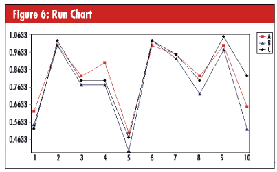

GR&R was used to verify a production-measuring system by analyzing 10 randomly selected production parts. Three employees repeated these measurements three times each for a total of 90 measurements. The same characteristic (e.g., diameter) was measured on each of the 10 parts.
The run chart in figure 6, below, illustrates the part variation as a zig-zag pattern for each of the three operators. The line patterns should be closely grouped, and corresponding line segments should be approximately parallel to each other.
In this case the pattern for operator B is lower than the others, a problem called “reproducibility” or “AV” for appraiser variation. Also, a few line segments aren’t parallel, a problem called “interaction” or “INT.” Interaction is a type of error caused by inconsistent differences of bias with one operator over different parts. Note that operator B fairly consistently measures parts as being a little smaller than operator C’s measurements; this bias is consistent across all parts, so there’s little interaction error. Operator A, on the other hand, is sometimes much higher and sometimes much lower than operator C; thus, there’s interaction error.

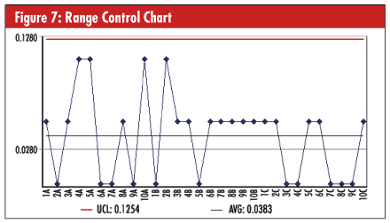

The range control chart seen in figure 7 below shows the variation experienced by each of the three operators during the three times that they measured the same part. The first 10 points are operator A, and the last 10 points are operator C. Key things to look for here are that detectible variation is present, and there are no out-of-control signals such as a point outside of the control limits. Points outside of the control limits would suggest that typos or measurement glitches had occurred. This chart meets the basic requirements.

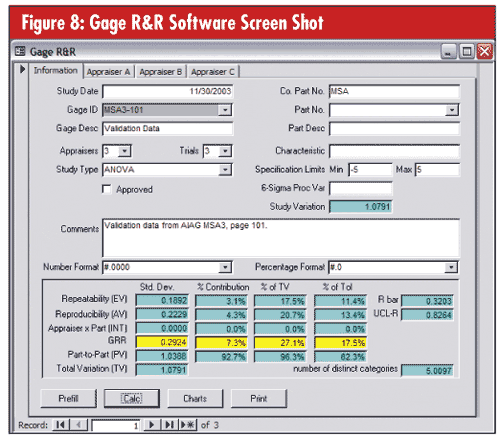

The calculations at the bottom of the software screen seen in figure 8 below are used to determine whether any of the problems found are big enough to worry about.
Customers usually express their requirement as a maximum limit for the combined variability of repeatability, reproducibility, and interaction, or GR&R. Usually, the limit is expressed as a percentage of total variation, or a percentage of tolerance, or both. Sometimes customers specify instead a suitable limit for one of the other statistics, as seen in figure 8.
Note that the software can only calculate interaction when the analysis of variance (ANOVA) calculating method is specified; otherwise, interaction will be ignored. Also, failure modes that aren’t statistically significant will display as zero.

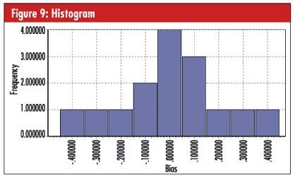

Bias test
In this example, a gauge was selected as representative of its type. Following calibration, a single reference value (e.g., gauge block) would have been measured 15 times instead of once. The histogram in figure 9, below, shows that the average difference between the gauge and the reference value, or bias, is slightly larger than zero.

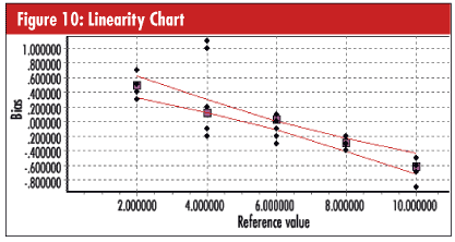

The linearity test is, in a sense, a more elaborate bias test. Multiple reference values (e.g., gauge blocks) are used to see whether bias might vary according to the size of the reference value. In the example in figure 10, below, the device was first calibrated at 6 inches, and then five different reference values of 2, 4, 6, 8, and 10 inches were measured 12 times each. In the linearity chart, we’re looking for four things:
1. Do the various groups of points have a good fit to an imaginary straight line? (Mediocre in this case.)
2. Is the imaginary straight line nearly horizontal with zero slope? (No.)
3. Does the lower curved limit stay below zero bias and the upper curved limit stay above zero bias? (No.)
4. Does the imaginary straight line intercept the vertical axis of the chart (the axis is shown here at the left side of the chart) near zero bias? (No.)

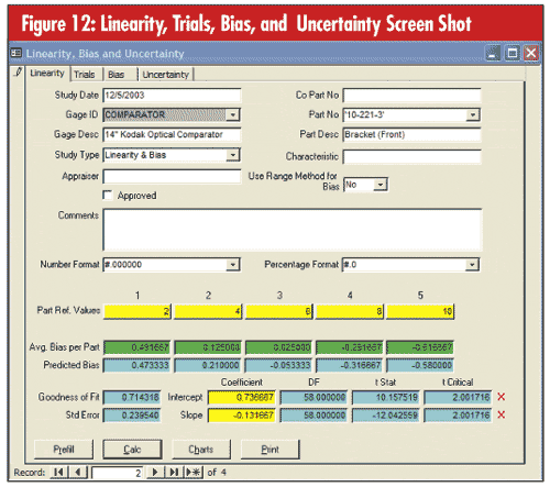

The screen shot in figure 12, below, uses standard statistical limits to confirm that the intercept and slope are too far from zero.

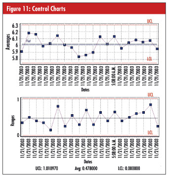

The stability test measures a reference value periodically to determine whether the gauge calibration has remained stable over the length of the calibration interval. Data are collected in about 25 subgroups of one or more; subgroup size is often either three or five. If the calibration interval were six months, you would then collect a subgroup each week. Companies that work with measurements which can’t be repeated should make sure that their software or spreadsheets can accept a subgroup size of one.
In this example, the subgroup size was five, and a subgroup was collected daily. The control charts seen in figure 11 below use limits based on repeatability.
In this case, the averages chart, which tracks bias, is in control, so there’s no stability problem. The ranges chart, which tracks repeatability, is in control, so there’s no consistency problem.
