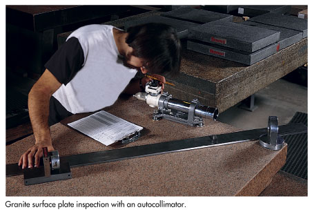

Every linear measurement depends on an accurate reference surface from which final dimensions are taken. Precision granite surface plates provide the best reference plane for work inspection and layout prior to machining. They are also ideal bases for making height measurements and gauging surfaces, parallelism, etc. A high degree of flatness, stability, overall quality, and workmanship also make them ideal bases for mounting sophisticated mechanical, electronic, and optical gauging systems.
The most important element in the performance and life of granite surface plates is the percentage of quartz that is present in the stone. Quartz is more than twice as resistant to wear as the other minerals in granite. It provides bearing points that have a hard, highly polished, smooth character, and that protect the accuracy and finish of the surface plate and the tools and instruments used on it.
For example, Starrett offers pink granite, which has the highest percentage of quartz of any granite. Starrett’s charcoal-black granite also contains quartz, although a slightly lower content than pink. Higher quartz content means greater wear resistance, and the longer a surface plate holds its accuracy, the less often it will require resurfacing.
Surface plates without work-clamping ledges are recommended for sustained accuracy and reliability. Ledges are for work-clamping purposes only. If excessive torque is used when applying clamps to ledges, it can adversely affect measurements taken near the plate edges. If clamping is important, T-slots and threaded metal inserts may also be installed in the surface.
Some applications may warrant customized, special plates. For example, a custom-made plate might be needed for inspecting oversize parts and assemblies, such as diesel engine blocks and crankshafts, vehicle frames, missile components, and ground-support equipment. Or perhaps a special plate or a modification to a standard plate might be required for work-holding attachments, such as threaded inserts, studs, adaptor holes, T-slots, and dovetails.

All surface plates must pass a critical final inspection to prove that their surfaces are within the specified tolerance. The final inspection is typically done with an autocollimator in a controlled atmosphere. This instrument is checked and certified against standards traceable to the National Institute of Standards and Technology.

Surface plates should be checked on a regular basis for wear using a repeat reading gauge with a manual indicator. Generally, long before a surface plate has worn beyond specifications for overall flatness, it will show worn or wavy spots, which will produce measurement errors. The reading gauge will readily detect these error-causing areas.
Simply set the gauge on the plate and zero it at any point on the table. Move the gauge over the plate, and if the indicator moves more than 0.000025 in. for an AA plate, 0.000050 in. for an A plate, or 0.000100 in. for a B plate, then the plate may have some high and low spots and be out of tolerance. Specifically, the tolerance must repeat from side to side within the specified tolerance range to be an accurate plate.
An effective inspection program should include regular checks with an autocollimator to provide actual calibration of overall flatness traceable to NIST. If tolerance variations are excessive, the plate can be transferred to work involving less accuracy, or it can be resurfaced to restore its original level of accuracy. Outside facilities or manufacturers are available to assist with the resurfacing process.
