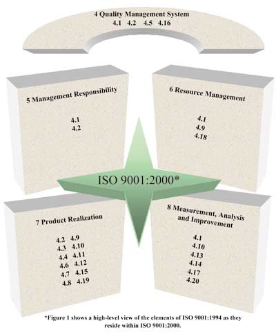

 It's important to note that the revisions have affected six key documents in the ISO 9000 family: ISO 9001, ISO 9002, ISO 9003, ISO 9004, ISO 8402 and ISO 9000-1. ISO 9001, 9002 and 9003 are combined into one document--ISO 9001:2000. ISO 8402 vocabulary is now combined with the fundamentals and titled ISO 9000:2000. ISO 9004 has also been realigned with ISO 9001. These two standards are considered a consistent pair and are intended to provide organizations with guidance to move beyond the basic requirements of ISO 9001.
 As previously mentioned, the FDIS contains editorial changes (wording, etc.), and some paragraphs have been moved between sections. However, the intent of the standard has not changed since the DIS was released. Figure 1 depicts how the elements of ISO 9001:1994 have been redistributed to the sections in ISO 9001:2000.
Figure 1: ISO 9001:1994 Elements Within ISO 9001:2000
