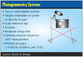

Photogrammetry
Photogrammetry is based on digital camera technology. The instrument takes a digital image of the target and was originally used with film cameras for mapmaking. “During the past 15 years or so, digital cameras have made photogrammetry more adaptable to large-part measurement,” says Gary Card, marketing manager for Brown & Sharpe.
Photogrammetry works by taking an image of the target and comparing it to something that would give it relative size; a yardstick is a rudimentary example. The user puts the yardstick somewhere in the image and captures the relative position between the target and that marker.
Modern photogrammetry systems use two or more digital cameras to capture an array of LEDs embedded on a probe. A computer uses the location of the LEDs to determine the position of a point in space.

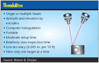

Theodolites
Theodolites use optical sensors and encoders to map data points and record the position of a part. They typically contain an electronic system capable of triangulating targets in relation to the part, but this type of system doesn’t scan the part. Theodolites are a good choice when accuracy is more of a concern than speed.
The principle behind the theodolite is similar to that of the laser tracker in that it uses motorized devices to develop the horizontal and vertical readings, the angle readings, and the distance readings from the beam that it emits.
Walter Pettigrew of Carl Zeiss IMT Corp. explains how this technology works. “Let’s say you have three optical devices, and you point all three of them at a spot on the part,” he suggests. “You can triangulate and locate that feature. Then, if you focus it on another feature, you can relate the distance between them--much like surveyors on a construction site. You first have to establish three locations and get the distances between them. With basic geometry and trigonometry, you can calculate the part’s position.”

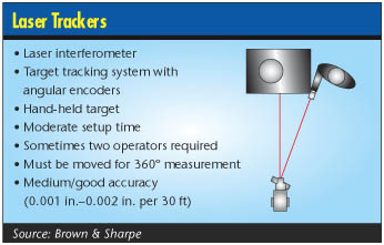

Laser trackers utilize a laser beam to collect data from retroreflective targets located on the part. The beam senses movement of the mirrored target and follows its location. Data points are typically recorded at near 1,000 points per second. In order to calculate the information, a laser tracker uses a laser interferometer, two precision encoders and software. An advantage to using a laser tracker is that it provides consistent accuracy and repeatability.
For instance, FARO’s laser tracker has a range of 70 m. It sends out a laser beam to a spherically mounted retroreflector. The return beam from the SMR is followed by the tracker. The tracker reads the distance and horizontal and vertical angles to the target 1,000 times per second. Software reports the data in X, Y and Z coordinates. The laser tracker can be used with a single hand-held target or can “point and shoot” at an unlimited number of fixed targets.
The laser tracker and laser scanner are both highly precise, have large working ranges and utilize lasers. There are some distinct differences, however. The laser scanner is fully noncontact, whereas the tracker measures the location of a retroreflector that comes into contact with the part. Because the tracker relies on retroreflectors, there is some manual work involved in moving them to different locations on the part. The scanner, on the other hand, is automated.

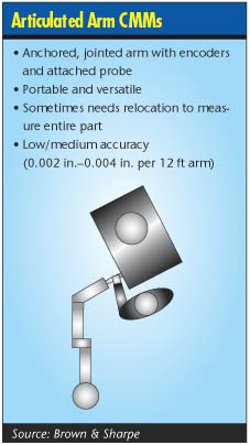

Articulated-arm CMMs, such as the FaroArm, fall under the category of “large-part noncontact measurement systems,” not because they’re capable of scanning a large part but because they’re flexible and portable enough to work around a large part.

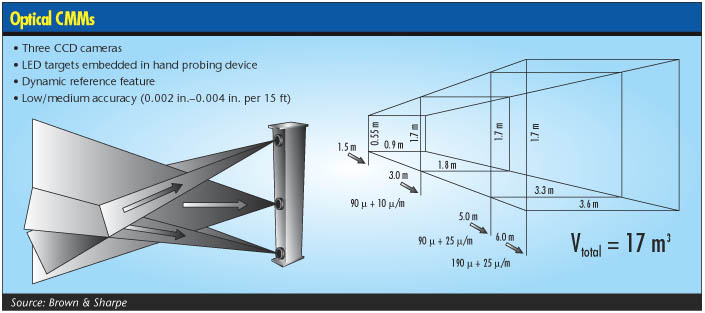

In the realm of optical CMMs, Zeiss offers the Eagle Eye. On a normal three-axis CMM, there’s another three-axis manipulator. On the end of that manipulator is a laser scanning device. In other words, it throws a laser line on the surface of the part and measures everything that the line comes into contact with.
“Part of the reason we have a sophisticated manipulator on the end of the machine is that it’s relatively important to keep the laser normal to the surface of the component,” explains Pettigrew. “Lasers on CMMs have been around for at least 20 years, if not longer. What’s different here is that the sampling rates and resolution are much higher.” Because there are times when contact measurement is integral, the Eagle Eye system is designed to switch back and forth from contact to noncontact.
