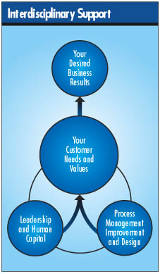

Renewing Six Sigma with a robust management system
When a company commits time and resources to a disciplined methodology such as Six Sigma, it must also develop a methodology to provide context, impetus and direction for change on an ongoing basis. In other words, organizations that get the most out of Six Sigma are those that have implemented a robust management system. With such a system in place, Six Sigma can be focused, refocused and directed in ways that optimize its value as a potent improvement tool.
The most effective way to maintain Six Sigma and the results it delivers is to fold it into an overall management system that identifies important problems as defined by critical business criteria. By doing this, improvements can be further enhanced with a broader set of problem-solving tools and personnel.
Such a disciplined management system has several key components:
It’s built upon business process management and leadership.
It’s constrained by desired business results.
It focuses on creating value related to specific customer needs.
The system must be supported by the organization’s people (i.e., human capital). These employees, in turn, need the enterprise to support their change efforts. (See the figure on page 26.) Ultimately, Six Sigma becomes one part of the overall system, which also leverages other tools and methods as needed.
An interdisciplinary business system supported by a Six Sigma program integrates other problem-solving methods and answers the question, “What’s next?” Rather than throwing away what’s good about Six Sigma, the system welds it to other critical business success variables. A robust management system optimizes Six Sigma’s function within the larger goal of ongoing, disciplined, data-rich, results-driven and measurable change.
