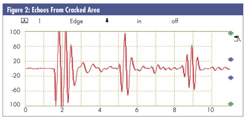

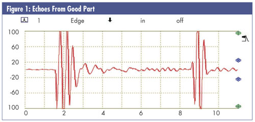

Figures 1 and 2 below illustrate a typical test involving a steel plate with a small hidden internal crack. Figure 1 shows the reflected echo pattern from an uncracked part of the plate, with the two large peaks representing the echoes from the front and back surface. In this case, the operator establishes that this is the pattern representing undamaged material and that any changes in that pattern indicate a change in the test piece's condition. Figure 2 shows the different pattern from a cracked area, with a third peak appearing between the other two. The presence of a significant reflector between the front and back surfaces of the plate indicates a discontinuity, in this case a laminar crack.
