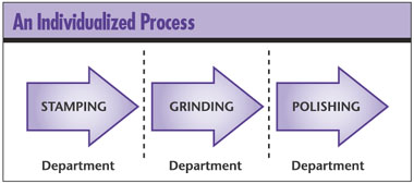

For example, consider the manufacture of widgets. The three key activities in widget manufacturing are stamping, grinding and polishing. A traditional widget manufacturer divides these activities into individual departments, each with its own manager, staff, equipment and supplies, as illustrated below.
From one perspective, organizing the company like this makes a lot of sense. The work is cleanly divided into discreet activities, with specialists doing their jobs and only their jobs. Measuring the output of individual activities is easy. At the beginning of the 20th century, Frederick Taylor and Henry Ford used this approach to achieve new levels of productivity from, and control over, employees. With cleanly divided departments, employees are focused on their own work and little else.
Ironically, this focus is also one of the drawbacks of the approach. Everyone concentrates exclusively on his or her job and really doesn't understand how the work contributes to the organization's greater goal. Departments try to excel individually without regard to the organization's overall excellence. Each department measures its output and its efficiency, doing whatever it can to improve this performance. Such a structure works fairly well when an organization makes a large quantity of a few products and it can sell everything it makes. The structure causes problems, however, when the product list expands and mass customization becomes critical. Of course, a wide product list and mass customization are virtually the norm now, for manufacturer and service providers alike.

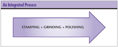

Orienting to the big picture
Consider how the illustration below differs from the one we've been discussing.
The functional activities of stamping, grinding and polishing are recognized as part of an overall process. No departmental boundaries exist between these activities. Personnel are cross-trained on different jobs so they can move from one activity to the next, based on the workload. Flexibility is built right into the structure. Because departmental boundaries don't exist, resources also flow smoothly from activity to activity. Information, supplies and materials all go where they're needed, when they're needed. One person manages the entire process and is compensated based on the process's overall performance, rather than just one aspect of it.
An organizational structure based on major processes makes perfect sense, but it's a radical departure for many enterprises. Most managers have come of age in a world where companies consisted of functional departments, not integrated processes. Understanding how processes function requires a different mindset than understanding how departments function.
The missing element here is the link between one activity and the next. In functional departments, links are taken for granted. If each department does its part, then the entire organization will succeed. Little consideration is given to the links between the departments, even though most problems occur there.
Process orientation highlights the links between activities because the links have become a visible part of the process. They aren't disguised by departmental boundaries. With true process orientation, if the links aren't effective, it becomes immediately apparent. The connections between activities become smoother because the process's dynamic nature demands that they continually improve.
