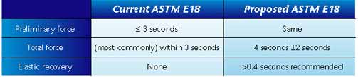

                                                    Table 1: The Proposed ASTM E18's Specified Loading Times
                                                      Elastic recovery is the indenter position after the removal of the additional force
                                                    (reading position). This is to allow for the elastic recovery of the part and the machine. The balloted draft of ASTM E18 doesn't mandate, but rather recommends, an extended
                                                    dwell time at elastic recovery. All manual machines are capable of meeting this aspect of the test, as the operator has total control over the dwell times. Some digital machines
                                                    may require modification to delay the capture of the reading at elastic recovery.  Myth No. 5
