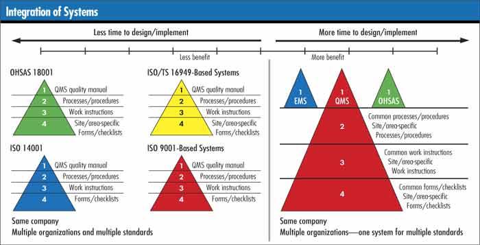

The figure below lists common standards, expected outcomes for each, functional areas affected and the multiple requirements for each functional area.

Knowledge is the key to moving forward on integrating your organization's standards and processes. Both vertical and horizontal levels of integration can occur within a company. Keep in mind, however, that integration is strategic and shouldn't be done in every case. For example, the figure above shows that the Level I manual can be integrated for EMS, QMS and OHSAS, but sometimes it's best to leave them as stand-alones so they can serve as pointers for how the organization implemented each standard.
Should a corrective action be integrated into one process? Maybe not. The organization, process, environment and other factors must be considered before deciding to integrate. Stand-alone systems are easier to implement than integrated systems. Integration requires sequencing and should be planned in stages.

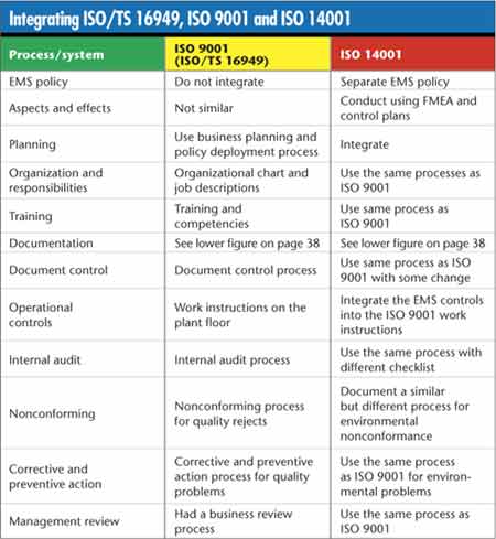

A large U.S.-based organization with a design center in Michigan and plants in the United States, Mexico and South America requested an initial assessment to determine what processes best integrated with its existing ISO/TS 16949 system. The integration was identified in the figure below.

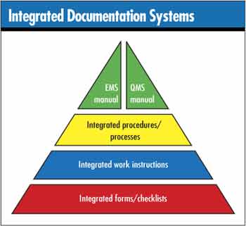

The organization documented an integrated system of procedures and work instructions. The plant-floor controls fully integrated both the work instructions for operating equipment and the quality checklists with EMS-related controls for significant aspects and their effects. The integrated documentation structure ended up looking like the one in the figure to the left, which shows a different manual for the EMS and QMS, respectively. However, the processes and/or procedures, work instructions, and forms and/or checklists were completely integrated for the EMS and QMS.
The key to this integration and implementation was identifying EMS aspects and effects using environmental FMEAs and control plans. The control plans were used for measuring and monitoring the controls.
