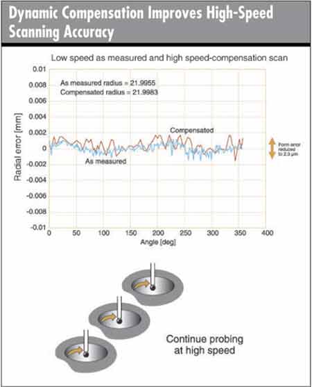

The figure to the right shows the effect of dynamic forces as scanning speeds rise, causing form error to increase. The blue plot shows low-speed readings (10 mm/sec or 0.4 in./sec), which provide an accurate assessment of feature size and form. The red plot of uncorrected high-speed readings (150 mm/sec or 6 in./sec) shows that the measured size of the bore decreases as dynamic forces take effect, causing deflections on the CMM.
To obtain acceptable accuracy on tight tolerance parts, the standard practice in CMM scanning is to take measurements at less than 10 mm/sec (0.4 in./sec), but often that's just not fast enough to give real-time feedback to the production floor.

Renscan5 provides far greater capabilities than the company's existing dynamic compensation technology. That product, RenscanDC, enables CMM users to measure at extremely high speeds, but with accuracies that previously could only be achieved at low speeds. RenscanDC is based on error-mapping the dynamic errors when measuring component features. These dynamic errors are normally repeatable. Scanning a feature first at low speed and then at high speed allows dynamic errors to be determined and a dynamic compensation map to be computed. Only one sample component from a production line needs to be scanned at the slow speed to generate the dynamic error map.
The correction data are saved and automatically applied to subsequent parts and batches, which can now be measured solely at the fast speed. The figure above shows the improvement in high-speed scanning accuracy by applying the compensation. RenscanDC is part of an optional scanning plug-in for Renishaw's universal CMM controller (UCC).

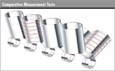

As an example of the gains in throughput that are possible with high-speed scanning, comparative measurement tests were conducted on two cylinder bores (each measured at six sections) and crankshaft bores with a single scan in each journal (see figure below). The measurements were first made at 5 mm/sec, a typical scanning speed. The measurements were then repeated with RenscanDC applied at a scanning speed of 100 mm/sec.
Inspection time at slow speed: 27 minutes, 27 seconds
Inspection time at fast speed: 4 minutes, 34 seconds
Reduction in inspection time: 83 percent

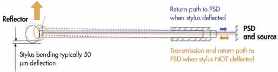

A new probe further minimizes the errors caused by the dynamic effects of high-speed motion and allows the use of long styli (up to 400 mm) without reducing accuracy. A laser is used to accurately measure the exact position of the probe tip, with a beam of light directed from within the probe body down a hollow stylus to a reflector at the stylus tip, as seen in the figure at the bottom.
The hollow stylus is designed to bend, thereby deflecting the return path of the laser beam which is received by a position-sensing detector (PSD), also mounted in the probe body. Movement of the laser spot on the PSD is translated into a measurement output by combining it with information about the geometry of the measuring head and probe, and each of the CMM-axis scale outputs. The exact stylus tip position can therefore be calculated. This process takes place while the stylus tip is dynamically scanning the part and the measuring head moves synchronously with the CMM. With minimal inertial effects on the laser beam, measurement accuracy is maintained even with very long styli.
