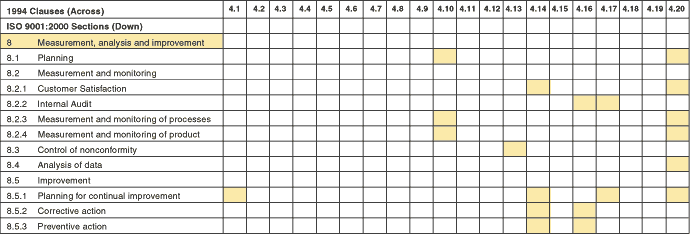

 The brief summary that follows provides simple explanations of the new requirements within section 8 of the ISO 9001:2000 draft international standard (DIS). Refer to Figure 1 to see where revisions are found in the DIS and how they compare to the 1994 version.

 Many organizations may first struggle with the overall concept of these subsections. Both incorporate components of 1994's 4.10 Inspection and testing and 4.20 Statistical techniques clauses. Quite a bit of the text from 4.10 has been moved to ISO 9004; however, the intent of 4.10 has remained: Organizations are required to determine what measurement and monitoring methods will be employed to ensure that both process and product requirements are met. ISO 9001:2000 doesn't specify inspection and testing activities for incoming, in-process and final product. Documented evidence must still demonstrate that products and/or services conform to specifications, and evidence must show what acceptance criteria are used. Furthermore, the methods employed must demonstrate that the processes and the products satisfy their intended purpose.

Figure 1: ISO 9001:1994 Measurement, Analysis and improvement clauses
Cross-referenced to the ISO 9001:2000 DIS
